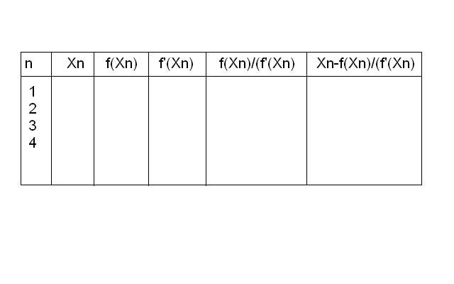

I'm working on part c). She has a set up a chart like this:
I guess I'm confused as to where I use n=4 and n=iteration
Yes. It's a pity n is used for 2 different things.
Let's just say that the n in your formula needs to be replaced by 4, while all the occurrences of n in your table should have been named k or i.
Oh ok, not sure why my teacher would do that to us :P
However, my numbers are not converging.
My n=1 is 3.175925926
n=2 is 2.986439461
n=3 is 3.191986488
n=4 is 2.970703369
I stopped there because they should be converging to 3.16227766.
Here's what I am using:
f(x)=x^4-100
f '(x)=4x^3
so, [itex]x-\frac{x^{4}-100}{4x^{3}}[/itex], where x is the previous approximation (x1=3)
Am I missing something?

Not sure what you did, because starting from n=2 I get a different sequence, which is converging.
To make it explicit:
[itex]x_{k+1} = x_k-\frac{{x_k}^{4}-100}{4{x_k}^{3}}[/itex]
and
[itex]3.1759-\frac{3.1759^{4}-100}{4 \cdot 3.1759^{3}} = 3.162[/itex]
Not sure what I did either, but I redid it and got it in 3 iterations.
