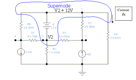

I have a circuit and I need to find the Nodal Equations that would mathematically describe the circuit, then proceed to finding the voltages at each node using Cramers rule and the currents at nodes 2 and 4. I don't think I would have much of a problem utilising Cramers rule. The problem I have right now is deriving the Nodal Equations.
However I would love to have the rest of my methods validated since I am simply unsure if I am on the right track or not
I am quite sure I have many errors in my attempted solution at deriving equations to describe the circuit. I am unsure what to do with the voltages sources.
Please find the diagram of the circuit and my attempt at solving the problem in the attached files.
Thank you very much in advance!
The 12V battery fixes the potential between your nodes 1 and 2, so they don't constitute independent essential nodes. In fact, the two taken together comprise a "supernode".
Keep only one variable to describe the potential for the supernode (V1 or V2) and write a single node equation. Suppose you keep V2 as the variable for the supernode, then the potential at the former node 1 connections would be "V2+12".

So I take the super node and consider it as a combined node consisting of node 1 and node 2?

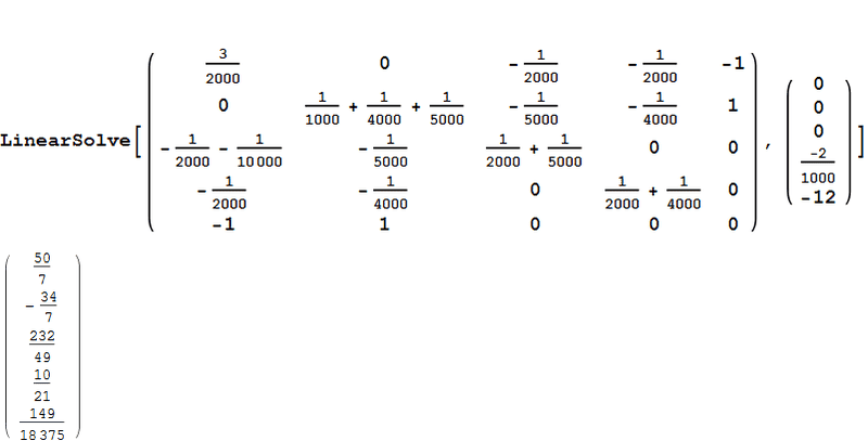

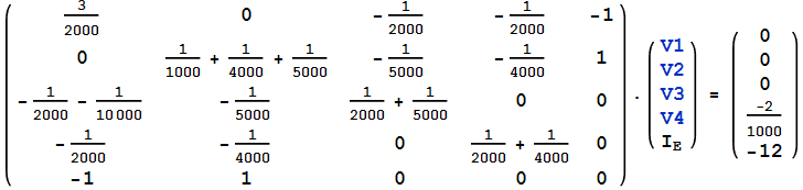

Another way to deal with voltages sources without considering "supernodes", is to use Modified Nodal Analysis:
http://www.swarthmore.edu/NatSci/ech.../mna/MNA2.html
MNA will give the current through the voltage source directly. For your problem, the MNA formulation in matrix form would be, with the source current denoted IE:
Solving the system, we get:
The current in the source is 149/18375 amps.
I would use MNA but a 5x5 matrice is not very attractive...

Without using MNA, you could get the current in the source by knowing the current in R1, R4 and R6. Then you will have all the currents at node 2, which you can show all sum to zero.
You already got all the node voltages in post #7; I only showed the MNA solution as an example of an alternate method to get the current in the source directly.
