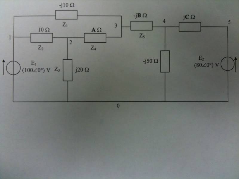

I would be grateful of any advice on how to solve the problem below.
My aim is to find the voltages at nodes 2, 3, and 4, by means nodal analysis and thus creating simultaneous equations and solving them using matricies or matrix in order to prove that these theories work.
I understand kirchhoffs law etc however its the complex numbers that are throwing me when working out the equations at each node.
, e.g multiplying and dividing by j etc.
I have tried for weeks now and it seems i am beaten yet again on my failure of rearranging algebra.
Any help would be great.
A=60 B=15 C=153
See diagram Below.
Cheers Chris
As an example, consider the isolated voltage divider consisting of E1=100, Z2=10, Z3=j20.
The voltage at point 2 would be
V_{2} = E_{1} \times \frac{Z_{3}}{(Z_{2}+Z_{3})}
Adding Z2 and Z3 is straight forward: Z2+Z3 = 10 + 20j. This is an ordinary complex number, with an amplitude and phase angle as usual. The fraction E1*Z3/(Z2+Z3) can be reduced by multiplying with the complex conjugate to a more familiar form:
V_{2} = 80 + 40j
Since Z3 is a complex (i.e reactive) component, the phase angle,\phi, at V2 is altered:
\phi = {tan}^{-1}(\frac{40}{80}) = 26.6 \:deg
There's nothing mystical going on here. It's just a series-parallel circuit, but -- due to the reactive components -- you need to carry with you the phase information, which means you need another dimension (the complex plane).

Be careful not to do too much of the poster's work for them. This is homework (originally misplaced in EE where you saw it and replied), so the original poster (OP) needs to do the bulk of the work.
However, you left the rest of the problem for him, so I'm going to leave your description for him. Let's see if that's enough for him to follow your lead and finish the solution.

thankyou for your reply, i will try again using your ideas.
The circuit i understand, but its the parralel reistor Z1 that confuses me when working out the voltage at 3 using nodal analysis.
