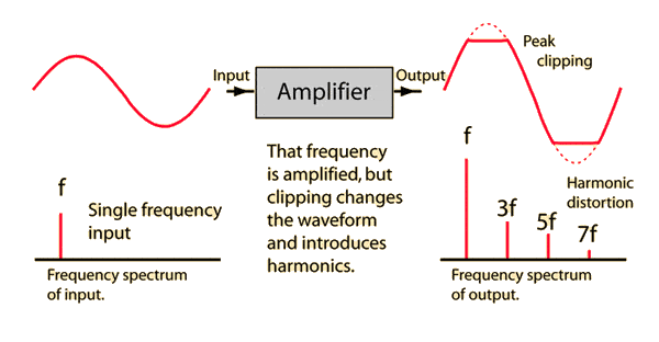

Clipping a sine wave results in higher frequency harmonics. These extra frequencies can get into your circuit and is called "noise" albeit not like the random/thermal noise that chaoseverlasting mentioned.
Here the extra frequencies due to clipping are odd harmonics; hence the 3,5,&7.
http://hyperphysics.phy-astr.gsu.edu/hbase/audio/amp.html"
