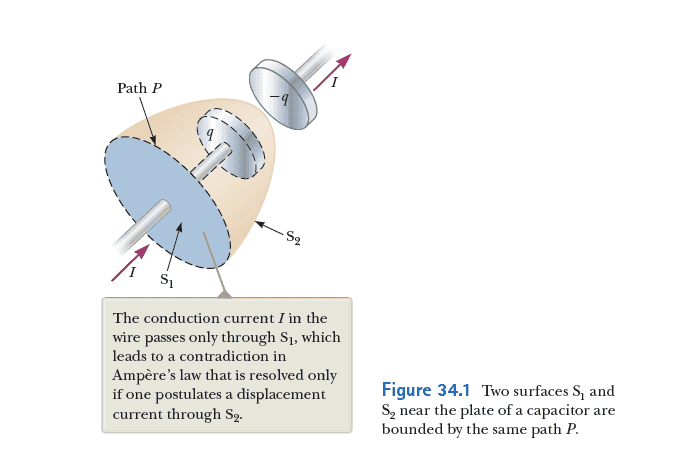

In addition to what @ZapperZ said, it actually cannot be done with Ampere’s law. The violation of the continuity equation causes a serious problem.
Recall that you define a loop, then define a surface whose boundary is the loop, and that it can be any surface with the boundary. If you have a finite wire and a loop around the wire, then you can choose a surface crossing the wire or a surface going around the wire. Both surfaces are valid, but the current is different.
This can be fixed by having charge accumulate at the ends and create a dipole E field, and adding the displacement term to Amperes law.
Could you elaborate on the point of surface going around the wire. Also how is the current different in both cases ?
For example
The current is different through the two surfaces, ##S_1## and ##S_2##

Dale said:
The Biot Savart law doesn’t have the same mathematical issue; the results are mathematically well defined but non-physical because of the violation of the continuity equation.
For exampleView attachment 218563
