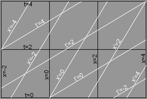

Have you ever heard of space-time diagrams, cmb? I think they will answer your question.
Here is a space-time diagram for the case where one observer is stationary. The stationary observer concludes that the moving observer is slow, because he uses the green lines to compare his clock to the moving observer.
The moving observer concludes the stationary observer's clock is slow, because she uses the red lines to compare clocks, not the green ones.
This is strange, but not paradoxical. We haven't gotten yet into why the moving obserer uses the green lines, but once you accept that they do, I hope you can see how it resolves the apparent paradox.
We can get into the why of it in another post, or perhaps you have some other questions or issues...

Here is a diagram that may help:
Suppose that I am the clock at rest at x=2 (black vertical line). There are a bunch of clocks (white nearly vertical lines) passing by me at .6 c. These clocks are synchronized in their rest frame, but in my frame they are not correctly synchronized. In fact, at t=0 I look and I see that the t'=2 clock reads -1.5, the t'=0 clock reads 0, and the t'=-2 clock reads 1.5. So the closest clock is set behind, the next clock is set OK, and the clock after that is set ahead. If I want to adjust my clock so that it always reads the same as the clock passing me then when the x' clock passes me, my clock reads .66 and his reads -.66, so I set mine back to match his. But then, because I had to set mine back to match the first one, by the time the next clock (x'=0) reaches me my clock reads 2. and this next one reads 2.66. So I have to run my clock faster in order to catch up. The clock after that was set ahead, so I also have to run my clock faster in order to catch up with that one. I have to run my clock fast, not because his clocks are fast, but because they are not synchronized.

Sorry, I don't understand that diagram. (What are the dots meant to represent, a clock tick? Why are they at different gap lengths on the lines, what is the significance of the angle chosen for the red line? I'd have thought the way to draw it would be dots of equal separation along each path, then the 'observation' line is one that intersects the other path at 90deg, no?)
Yes, the dots represent a clock tick. The detailed reasoning for the spacing of the dots is not necessarily required to understand why the twin pardox isn't a pardox, but it's interesting, I think.
Relativity tells us that \Delta t^2 - \Delta x^2 is constant for all observers (using units where c=1, and light moves at a 45 degree angle on the graph).
The spacing of the dots is 4 graph units for the stationary observer making \Delta t =4. Since \Delta x is zero, the interval is \Delta t^2 =16 in this case, For the moving observer, the spacing is \Delta x = 3 and \Delta t =5, and 5^2 - 3^2 = 25-9 = 16. So the dots are spaced at equal 4 unit intervals. The dots which occur at \Delta t =4 have an identical spacing of "proper time", computed by the formula above, said formula giving the results which an actual clock would measure, as the dots which have \Delta x = 3 and \Delta t =5.
The angle of the red-line can be derived by another space-time diagram, I'll do that in another post since you're interested. Again, while it is interesting to know why the lines are drawn the particular way they are, the exact reasoning isn't needed to be known to understand why the twin paradox isn't an actual paradox.

OK, onto the part where we show why the lines have the slope they do. First we have to talk about clock synchronization. There is a specified way of synchronizing clocks, called the Einstein convention, that's fairly easy to understand,that we need to follow to define the notion of "simultaneity" in relativity.
You take the worldlines of three equally spaced observers. The middle observer is moving along with the other two, and has an equal distance from both. If the middle observer emits a light pulse, the arrival time where it intersects the worldlines of the other two observers is the same, by definition,because it's traveling equal distances to both observers, and because light has a constant velocity relative to all observers.
But first, a quick review. Before we draw a complex diagram with the worldline of three obserers, let's review the diagrams for one observer.
In space-time diagrams, time points upward on the diagram, and the horizontal axis represents position. The diagrams I'll draw will all be scaled so that light is represented by a 45 degree line on the diagram, i.e. so that c=1.
Quick quiz questions for understanding:
A) Is the worldline below that of a stationary or moving observer?
B) The same as above: is the worldline below that of a stationary or moving observer?
Now, we get to the more complex diagrams. They'll give away the answers to the above questions, but hopefully you already knew the answer anyway.
We need to draw the worldlines of three equally spaced stationary observers, and we want the middle one to emit two light rays. We draw it out, and we get this:
[/quote]
The red line connects two points that occur "at the same time" in the stationary frame. It's what we expect in the stationary frame, events that occur at the same time have the same t coordinate.
Now we do the same thing in the moving frame. We get this:
We can see that the concept of "at the same time" is _different_ for the moving observer than it is for the stationary one.
What is the exact angle of the red line? Well, it turns out that the angle the red line makes with the horizontal x-axis is the same as the angle that the worldline of the moving observer makes with the vertical t-axis. This can be demonstrated formally with similar triangles.
The important conceptual point, though, even before we worry about the value of the angle, is that the notion of simultaneity is different, that the lines connecting simultaneous events in the moving frame are different (slanted) relative to the lines connecting simultaneous events in the stationary frame.
