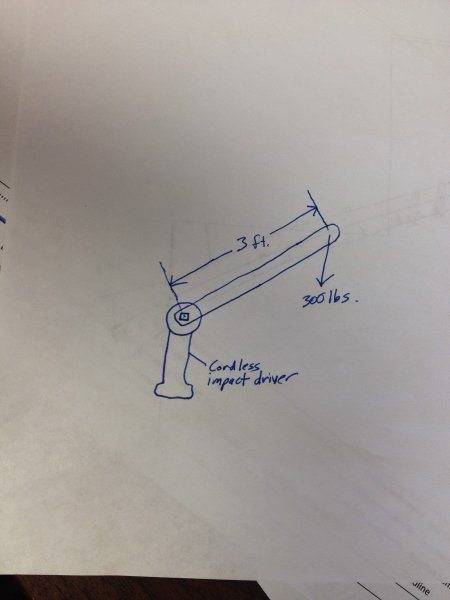

I need to lift 300 pounds with a lever arm 3 ft long. So, I need 900 ft-lbs. A electric impact has 1100 ft-lb of nut-busting torque. Will this electric impact work? What does nut-busting mean?

Please see attached layout.
How are you going to hold the impact driver once the load starts to rise. There will be 900 ft.lbs on the handle continuously.
Maybe you need to use a gearbox mounted on a solid base, a boat winch or a chain block. Some small lifting arms for vehicles use a hydraulic ram.
How often will you need to lift it? Why?
I drew a more detailed sketch of device.
Unfortunately your design will probably not work for a number of reasons.
(A). The torque / time characteristics of a cordless impact driver will not provide a sustained torque of 3 ft * 300 lbs = 900 ft.lbs.
(B). The impact driver mounting will be torn off the table by the continuous 900 ft.lbs, with or without the added impact.
(C). The device overhangs the edge of the table, the table will probably overturn.
There are many different solutions available. Choice of the best method will depend on why you really need to do this?
Nice thanks for the input. Would a electric impact cordlessdriver lift 260 lbs with a 3 ft lever arm? The maximum torque of the electric impact cordless driver is 780 ft lbs.
No.

That to overcome gravity you need constant torque not just brief pulses of it.
ok it does not give a constant torque. Thanks for the info. This is a great forum.
