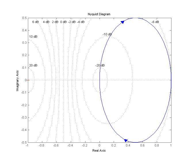

I'm trying to make a Nyquist diagram based on experimental data obtained of the gain and phase of a high-pass RC filter which has the transfer function:
##\frac{V_{out}}{V_{in}}=\frac{R}{R+1/(j \omega C)}=\frac{1}{1-j\omega_0/\omega}##

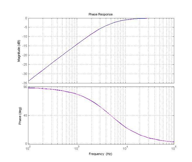

Here are the superimposed experimental and theoretical Bode plots:
And here is the theoretical Nyquist plot I made by using the equation above with Matlab's nyquist() function:
So how can I make an experimental Nyquist plot (using the two sets of data obtained on amplitude and phase of the filter)?

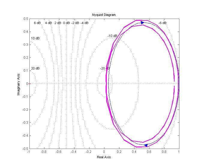

If your system doesn't have any zeros or poles at the origin, then its Nyquist diagram is just its Bode plot in polar form with its complex conjugate superimposed on top of it, so if you have your gain (in linear magnitude) and phase (in radians) in a couple of vectors, then one half of the Nyquist diagram is simply given by:
Code:
z = gain.*exp(j*phase);
plot(z)
You can complete it using:
Code:
plot([z;conj(z(end:-1:1))])
You'll have to mentally add the direction, but that should be simple enough.

I assume you're talking about the form that shows break frequencies for use in, for instance, drawing Bode plots using asymptotic approximations. That form isn't necessarily "correct", or even good, for drawing Nyquist diagrams. You can often find a much more convenient polar form of the transfer function for these, i.e. it's not always better to draw Bode plots first and then use them to sketch the Nyquist diagram (Edit: Just to elaborate, straight lines in Bode plots aren't that great when drawing in polar form).
In any case, the OP's question was about plotting a Nyquist diagram from a data set, not a transfer function.

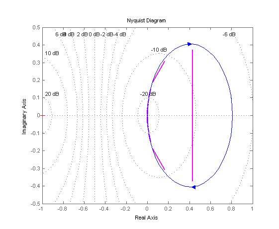

Thank you for the helpful post Miles. But how would you modify the code if the transfer function contains a zero/pole at the origin?
For instance I tried your method for an LC resonant circuit (the notch filter) which had a transfer function of:
##\frac{V_{out}}{V_{in}} = \frac{R_2}{R_2+z_p}##
with ##z_p = \frac{R_p}{1+jR_p(\omega C -\frac{1}{\omega L})}##
It simplifies to ##\therefore \frac{R_2 s}{R_2 s + R_ps + (1/C) - (1/L)}## (s=jω)
Clearly it has a zero at the origin. In fact here is the diagram I got when I tried using that code (magenta is the experimental, blue is the theoretical):

Actually in the previous plot value of Rp was not correct, when I correct that the two plots almost completely overlap. However in the experimental diagram why do we have these straight lines tangential to the curve?
You don't have to modify it, you just have to remember that the frequency response of the system only gives part of its Nyquist diagram. That fact is more important when you have a zero or pole at the origin, because you then have to change the Nyquist path to "go around" that zero or pole, which either gives an arc around the origin or out at infinity, respectively, in your Nyquist diagram:

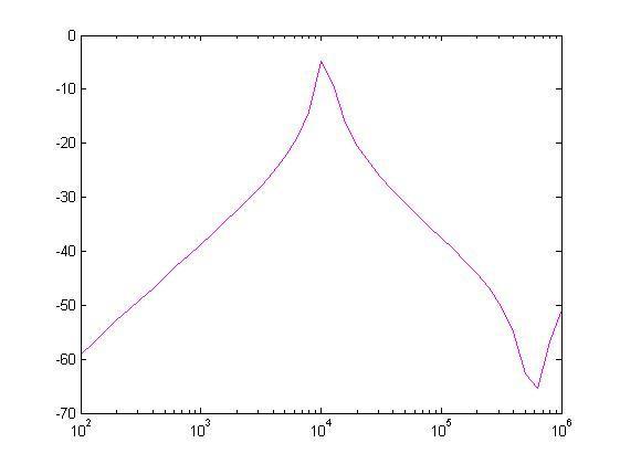

They are, however, going to look a bit odd for the data sets you've provided. You only have a couple of data points at the resonance frequency of your filters, which isn't going to make for a great Bode plot or Nyquist diagram. You should have a higher resolution around where the magnitude/phase starts changing rapidly with frequency. 'plot' in MATLAB does linear interpolation between points, so you can get some odd looking graphs if you're not careful.

Yes, I did use separated values when entering the data set. I've attached the experimental Bode plot (gain being on the vertical axis).

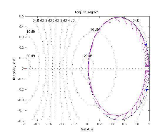

Is there any way to somehow smooth out the diagram a little? With the correction this is how the plots look like so far:
Band-pass:
Notch
I don't see why there's a double line in the last one...
As you can tell from your first diagram, there's only so much fidelity you can get using linear interpolation with so few data points around the resonance frequency. The problem is that the phase changes rapidly (at high magnitude) from something positive to something negative in a few data points, so you get those straight lines darting around and connecting those few points.
It's not that big of a deal for a notch filter, however, since that phase transition occurs at very low magnitude, so it really doesn't alter the overall shape of the Nyquist locus.
Compare how rapidly the magnitude/phase changes with frequency for your RC-circuit and your LC-circuits. You don't have the same amount of data around where it matters!
If you don't want to measure any more data, then it might be an option to just superimpose your data on a Bode plot of a filter with a transfer function of the right form, but where you can adjust the parameters until "it fits". Just try and eyeball it for now - I don't think it's worth getting into system identification just for these simple systems.
It's because, for the ideal filter, "one half" of the Nyquist diagram is already an ellipse in the complex plane. When you superimpose its complex conjugate, you do so right on top of the locus that's already there.
For your data set, that second "go around" isn't going to fit perfectly due to measurement errors and what not, so you get to see the whole shebang.

I should probably have mentioned something in my first post: 'Phase' in the complex plane is synonymous with 'angle'. In your original post, can you see how that Bode plot traces out the upper half of the Nyquist diagram?
A magnitude and phase pair in the Bode plot gives a point in the complex plane with the same magnitude and phase (angle).
