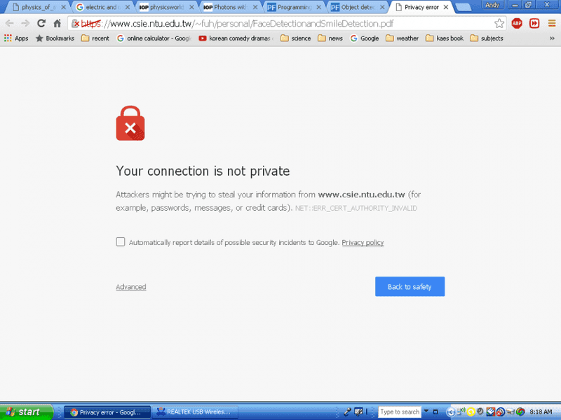

My Google Chrome browser gives me the following warning when I click on the link above,

ie. https://www.csie.ntu.edu.tw/~fuh/personal/FaceDetectionandSmileDetection.pdf
Yeah but those just explain how the algorithm works.
