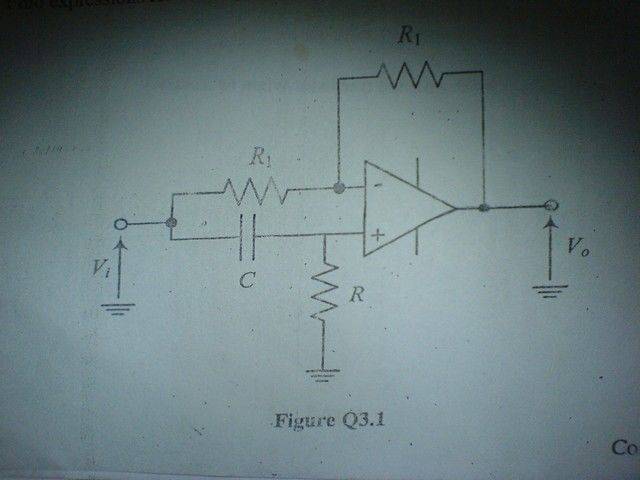

i have this exam paper question.
  1. derive an expression for transfer function
  2. find expression for the magnitude and phase of the response
i have attached circuit diagram below
2. The attempt at a solution
i derived
for first question
Vo= 2RC(dVi/dt) - Vi
(Vo/Vi)= 2sRC - 1
for second question
magnitude = |Vo/Vi|=|2jwRC-1|
and don't know how to find phase.
I'm not sure about my answers as i learned them from book that has no this kind a examples. so I'm glad if someone can show me how to solve this
Thanks

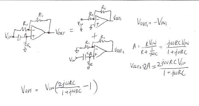

I assume it is an ideal voltage source which is 0 impedance. You basically divide the circuit into 2 half.
1) the C and R that form the high pass into the +ve input. The output is just gain of 2 of the voltage at the junction of the C and R.
2) the Inverting configuration form by the two resistors into the -ve input and feedback from the output. This has an inverted gain of 1 at the output.
3) Using super position to sum the two transfer functions as the final output. Basically, at low freq, no signal input into the +ve input so the circuit has a gain of -1. At break frequency of C and R, signal start to drive into +ve input and start canceling the other side so output roll off. At break frequency, output is 0. Beyond break freq, the circuit has a gain of +1.
I post a wrong answer 2 hours ago, sorry. I am also experimenting puting a jpeg on this also, apparantely it still won't display on the post. Still come out as an attached file. Please double check my work. I have been making mistake lately at my old age! But I am sure the idea of super position stand. Just calculate the result in polar form to get the phase angle.

I have send it to your email.
I can down load from here. Must be still waiting for approval. I still have not find a way to put the drawing directly onto the post, any attachment need a day for the moderator for approval. Bummer!
Almost forgot! Break freq. is 1/(2 [tex]\pi[/tex] RC).
Let me know if you receive it and we can talk more. Just remember I am not a teacher or tutor, double check my stuff.

Good question! One thing is at break frequency, it is only 45 deg. lag. At low freq., Point A is 90 deg lag but the amplitude is low, don't matter. At freq>>break freq. there is very little lag so it is pretty much no lag.
I think if you plot the equaion out, you should see the respond. Seems like the amplitude will go very low at break frequency. The signal actually go through 180 deg shift( from -Vin to +Vin).
I am an engineer and I have been designing opamp stuff for many years. In real life, we have a requirement and we provide a solution! This will not be a circuit I would use for a notch filter.
I don't think this is right, Yungman. This circuit is an all-pass network, and the amplitude response is constant with frequency; only the phase shift changes with frequency.
Your last expression for Vout in post #2 can be re-written as:
jwRC-1
------- * Vin
jwRC+1
which is a classic all-pass response.
jwRC-1
------- * Vin
jwRC+1
Maybe you are right. I got the transfer function and I just guess the output will get lower at [tex]\omega[/tex] = 1/(RC). because it is in opposite direction. I never really sit down and go through it. But since you mentioned, I calculate at break freq. The output is -j and amplitude still is 1 at -90 deg.
