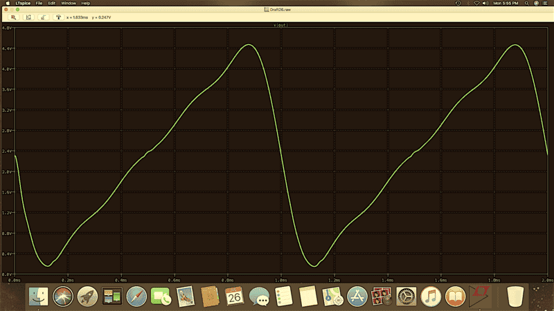

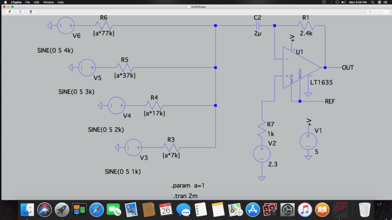

Well, here it is with the LT1635. I could not get to 5V because of the limitations of the op amp I believe. I had to add the capacitor also. I tweaked the resistors further but I think it is not in the spirit of the exercise. Looking at the literature, this class of op amps has a lot of sophisticated uses and using it for a simple problem such as this I think is overkill. Still, it's fun to try.
Also, I'm working on a completely different approach so please don't spill the beans just yet.
Thanks.
LTspice schematic of an op-amp summing circuit: five sine sources (V3 to V6) feed weighted input resistors R3 to R6 with parameter a, into the inverting input of an LT1635 op-amp with feedback resistor R1 and capacitor C2, plus a 2.3 V reference and 5 V supply.
LTspice simulation plot of V(out) against time from 0 to 2.0 ms, showing a rising sawtooth-like waveform that drops sharply, repeating about every 0.8 ms and ranging roughly from 0.4 V to 4.6 V.

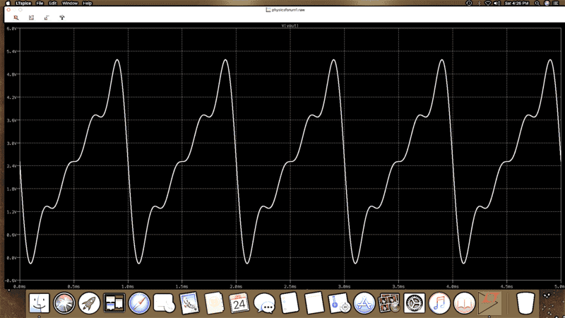

Yes. "Rail-to Rail" is always a lie. Those saturation characteristics graphs are one of the most important parts of the data sheet for a part like this. For a high impedance load you should be able to get within <0.1V or so if you're careful (i.e. don't make it source much current).
I'm not sure the exercise wants it to get to 5V. That would be the peak voltage for lots of harmonics, but with only 4 I think the top will be rounded off below that.

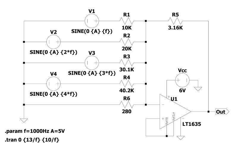

That cap isn't necessary if you choose the right resistor values. You seem to have missed the point about using a part with a built in reference to make the offset. The circuit below does this job with a single power supply, 1 IC and 7 resistors (although in the real world, I'd add a couple of caps too).

A better version, 1 less resistor:
Circuit schematic of an inverting summing amplifier with four sine sources V1 to V4 (SINE(0 {A} {f}), {2*f}, {3*f}, {4*f}) feeding R1 to R4 and R6 into an LT1635 op-amp, with R5 3.01K feedback to Out and a 6V Vcc supply.

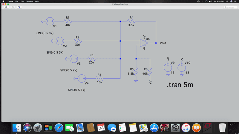

bob012345 said:

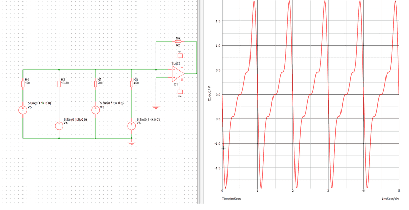

How did you come up with the coefficients of 10,20,30,40 and RF of 3.5?
I’ve arbitrarily used 10kohms for my RF with coefficients of 10kΩ, 13.3kΩ, 20kΩ and 40kΩ which should give me gains of 1.25, 2.5, 3.75 and 5.
I was hoping as there are 4 inputs at 5volts each that 5/4=1.25 and multiples of, would give a smoother wave form. However not quite the case.
Simulation screenshot of a summing inverting op-amp circuit with four sine sources and resistors, beside a red plot of X1 out in volts against time in mSecs, showing a repeating sawtooth-like waveform with steps.

Are you asking why the output solution for your circuit is the equation below?
$$ V_o = -R2( \frac{V5}{R4} + \frac{V4}{R3} + \frac{V3}{R1} + \frac{V6}{R5} ) $$
Or are you asking how to choose each of those gain terms (i.e. the resistor values)?

I was wondering how you came up with the gain values for each channel. But it seems I over looked the equation as mentioned by bob012345.
