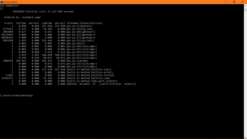

I wrote a piece of code to solve the problem but it still takes too much time to solve it Any ideas how can I improve my code, like adjustments that I can make ?

When I set Primes range to 8000 it took 18 min to give an answer I checked the solution for the 4 set of primes and it gives me the right result.(If you want to check print (G4r))
Any ideas how can I make my program faster ?

You should try timing each function individually to see how much time they take and then from there optimize the specific functions.
Its often said that program execution spends 80% executing 20% of the code. Try to find that 20% code and optimize it.

Use a sieve to sieve primes up to say 10 million. I think your time hog is that prime check procedure.

Consider profiling, ex: cProfile. This shows you how much time is spent by each function/method. Trying to guess is not the best choice unless you are very experienced.
How to profile, options - https://devopedia.org/profiling-python-code
I finally manage to run it . I am saying finally cause it was hard for me to find how to run it. I add the image.
Functions have names and you see the time that took to complete them.
Line 63 took 168 sec and that's the G3 = [] line other then that I run this code for prime range 5000.

İt seems that I need a better prime tester and a better con_test function.
227.948833517

I changed my prime code to Miller–Rabin primality test ( I didnt write the code myself I copied ) and I find the result in 8 min 30 sec. I also need to change the con_test() function for improved result ..
This runs counter to the advice earlier in the thread that the OP should learn to profile. He won't learn that if we tell him what the answer is. This is especially true if we guess.

Vanadium 50 said:
Optimization 1: A valid solution will have only numbers congruent to 1 mod 3 or 2 mod 3 (possibly including 3 itself) and never mix them. So we should make two lists, one starting 3, 7, 13, 19... and the other starting 3, 11, 17, 23... . This drops the number of tests in half, and will speed us up enormously when we start the brute force.
I did this and others suggestions are actually similar to what I am doing.
The first code that I shared on my first post is taking 41 min to solve the question .Now, I copied a faster prime cheker code which its taken from https://rosettacode.org/wiki/Miller–Rabin_primality_test#Python and then using the Vanadium suggestion I reduced to time down to 130±10 sec
I am not sure it can go down further then this but I am happy about it.
Here the last version

verty said:
Are you starting from the start each time you find a new prime?
what do you mean ? I am finding two pair then adding third prime by applying the rules.
