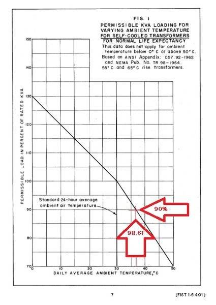

Do a search on the term "oil filled transformer loading", and read up. These https://www.usbr.gov/power/data/fist/fist1_5/vol1-5.pdf from the US Dept. of the Interior are a good place to start. Also, if applicable, consult with the organization that does your transformer testing and oil analysis. They will be able to advise you based upon their experience and knowledge of your transformer's ratings and condition I suggest bringing in a professional engineer to investigate this question, and advise you further.

@Asymptotic posted a great link in # 4, here's a snip..
At 90% load keep the room below 99 degrees F. Good luck with that in a steam plant in the tropics.
Your transformer instruction manual should have a similar guideline .

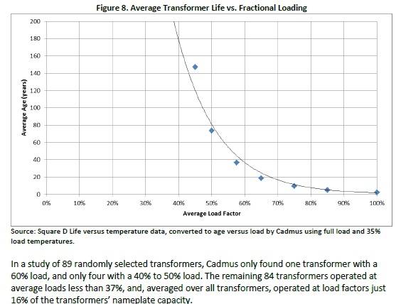

National Grid - Transformer Replacement Program Implementation Manual. This is specifically for dry type, low voltage transformers ranging from 15 KVA to 1000 KVA, but worth a read, and is the source of this graph.
ANSI C57.96 specifies a 20 year expected life at 100% load under a batch of other assumptions including an elevation of less than 1000 meters (3300 feet), freely flowing air convection, and an average ambient of 30°C which does not exceed 40°C.
In short, a cooler transformer lives longer.
It is also the reason for asking how long this transformer has already been in service. If your transformer has 20 years on it already, it is inadvisable to add more load, but rather to evaluate it's replacement with a higher capacity unit.
