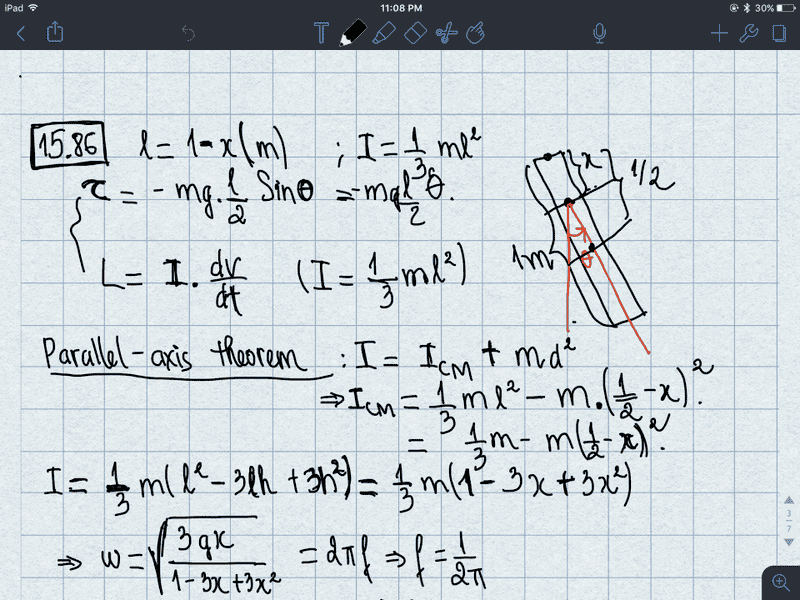

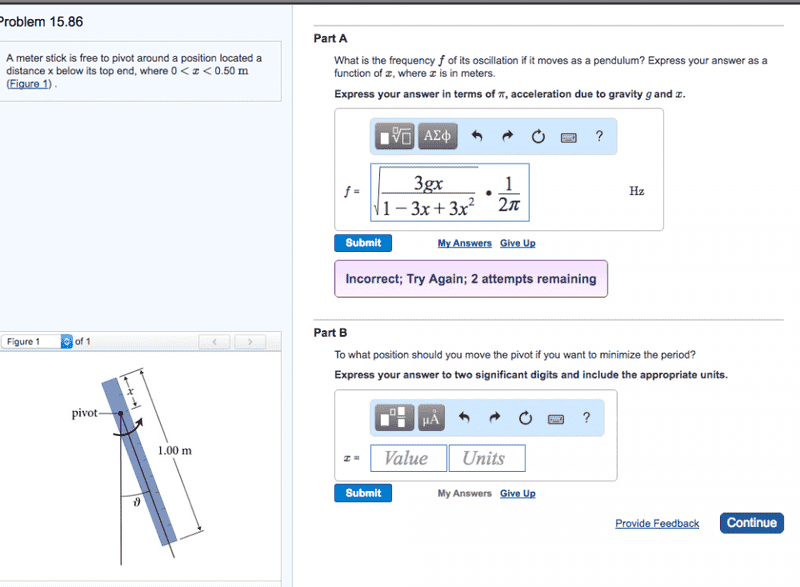

A meter stick is free to pivot around a position located a distance x below its top end, where 0 < x < 0.50 m(Figure 1) .
I attached my note.

Your expression for ##I## about the axis of rotation looks correct to me. Although I think I would have just used ##I = I_{cm} + Md^2## with ##I_{cm} = \frac{1}{12} M L^2##.
It appears to me that you have a mistake in the numerator of your expression inside the square root for ##\omega##. Review the general formula for ##\omega## and make sure you are interpreting the symbols correctly.

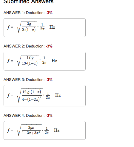

I tried that approach but I failed. Am I annoying?
It should give the correct answer. If you show your work, we can identify any mistakes. Make sure you are interpreting ##d## correctly. ##d## also occurs in the numerator of ##\omega##.

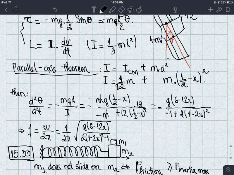

Can you help me check out my steps please?
You are setting it up correctly, but you need to be more careful with simplifying the expressions. Try it again and take your time.
Also, note that ##\frac {d^2\theta}{dt^2}## is not the correct notation for ##\omega ^2##.
##\frac {d^2\theta}{dt^2}## is the angular acceleration of the rotational motion.
But ##\omega## is the angular frequency of the simple harmonic motion; i.e., ##\omega = \frac{2 \pi}{T}##, where ##T## is the period of the simple harmonic motion.
