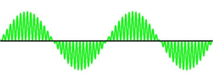

Probably seems like beating a dead horse here, but I thought I'd share this image as well.
What you are seeing is a stereo MPX signal without the pilot. The MPX signal consists of baseband audio and a double sideband suppressed carrier at 38 KHz. The signal in the link shows both left and right channels carrying the same tone. So the 38 KHz signal is carrying the same tone as the baseband audio. Notice how similar it looks to a stepped waveform. The spectrum looks similar except the 38 KHz does not have any harmonics.
Comment about stepped waveforms having a modulation effect is spot on.
