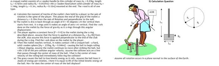

So far I've only done parts a and b and I wanted to post this up as soon as possible, I want to make sure if I'm on the right path so far.
part A) I know for this question I need to use the parallel axis theorem. What I did is I first found the moment of inertia of the rod first using I=(1/12)ML^2 , and also found the moment of inertia of the head (I=1/4MR^2 + 1/12ML^2). Then to find the moment of inertia of the mallet when held by the player at a distance of LP from the center of mass of the hammer, I derived the expression Ip = (Irod + Ihead + (mg + mh)(Lp + 1/2Lg)
part B) For this part I'm thinking the work done by gravity is just the change in potential? where the total length (Lp + Lh + 1/2Rh - 1/2 if we were to just calculate up until the center of the mallet head) is used in a cosine equation to find h.
so
x = some change in height
(total length / total length + x) = cos65°
and I just solve for x and use that in the potential energy equation?
Your thought processes seem OK. Just be sure to get the correct distances.
Note: gravity acts at the center of mass.

I am only unsure of the moment of inertia for the rod, since it is also shaped as a cylinder, I was either thinking whether to use the same formula as for the head, which includes using the given radius also?
It's probably easier to notice that the work done by force F(θ) swinging from θ to θ+dθ at distance R from the pivot is given by... what? Therefore the total work swinging from angle A to angle B is given by... what? (What's F(θ)?)
F(θ) I'm thinking it is torque.
so work done = R* (Fgravity)* (65°) ?
Ah right - the trick with the moment of inertia is to get the right orientation for the rotation when you apply the parallel axis theorem. The shaft and head have different orientations - but they are rotated in the same plane wrt to each other so it doesn't matter: use the same com formula. Be careful to get the distance to the com correct in each case.

Part c) I believe is just W = R * F using the new given values?
Part d) hmm this is a bit difficult, I know that the system is a perfect elastic collision with a free axis of rotation so that
linear momentum is conserved, angular momentum is conserved and kinetic energy is conserved.
I don't understand that last bit. Don't you have to add different parallel axis distances for rod and head? And it looks dimensionally wrong, the last terms just being mass * distance.
so
Yes, I would use the change in energy, but I don't think that gives the right distance. if the mass centre is a distance d from the axis, how far below the axis is it when at top of swing?
