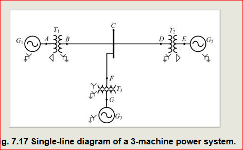

Firstly apologies for not returning to this earlier and thank you for your answers thus far however they did not touch on the problem statement, Initially in the post we had a embedded HV network using a combination of LV DG and GT sets stepping up through transformers with different vector groups.
DG Dyn11 .415/11kV (connected in reverse to obtain neutral)
GT Yyn11 .415 (standard running when synchronized to the supply)
These two transformer groups cannot be paralleled correctly due to phase shift when fed from the one network, my question therefore is:
Suppose the DG and the GT reference their LV voltages as L1 240https://www.physicsforums.com/file:///C:/Users/VOLTCO~1/AppData/Local/Temp/msohtmlclip1/01/clip_image002.png , L2 240 https://www.physicsforums.com/file:///C:/Users/VOLTCO~1/AppData/Local/Temp/msohtmlclip1/01/clip_image004.png , L3 240 https://www.physicsforums.com/file:///C:/Users/VOLTCO~1/AppData/Local/Temp/msohtmlclip1/01/clip_image006.png
Upon putting these phasors through their retrospective transformers there would seem to be a phase shift between the voltages of the two sets. Will this create a problem for closing the breaker?, remember the sets would be synchronized at 50Hz but the voltage angles would be different by up to 30 degrees...
clearly you don't parallel transformers on both their primary and secondary sides with 30 degrees phase difference.
What is not clear to me is - are you proposing that ? Are generators paralleled on low voltage side ?
Why cannot the generators be run 30 degrees out so the phase matches on secondary ?
Jim
the generators are not paralleled on the LV side but would deliver 415v at 0 angle if required, thus if one wanted to you could parallel on to a LV network quiet simply. The problem is the step-up transformers!. to run the sets out by 30 degrees would require measuring the voltage angle on the HV side and relaying the correction to the generator no?, no such equipment exists on site!

Where do you measure the voltages for synch when closing the breakers now? On transformer high side? Is that where your synchroscope senses voltage?
If there is no connection between your generators they can run at any angle
and you should see that on your synchroscope when matching up their speed for synchronizing them.
Here's a picture from a random 'net search on 'two generators one line diagram'
http://nptel.ac.in/courses/Webcourse-contents/IIT-KANPUR/power-system/chapter_7/examp_7.5.html
note G3 must be 30 electrical degrees out of phase with the other two , for its transformer is YY but other two transformers are ΔY .
Pardon me if i missed your question
but the above picture , shows how i interpret your problem statement :
"Can i parallel two generators through different transformers?"
Sure. The only thing locking them in phase is the interconnecting wires. Each machine is free to assume its own power angle .
If you synchronized a stroboscope to bus C and looked at the shafts of all three machines,
you'd see G3 in synch , zero degrees,
G1 and G2 out by ~30 degrees,
each of course plus its power angle.
So it seems to me you have assumed some absolute reference point for phase, maybe one generator
Make that reference point Bus C above instead of a generator and see if it changes anything.What have i missed?old jim
Thank you Jim
I have been looking at this incorrectly, provided the DG transformers are backwardly soaked then there is no drought that the could sync to the GT...
You have filled the hole in my understanding of correctly syn gen sets, again thanks...
