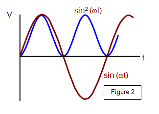

Here's a picture.
Graph of voltage V against t showing two curves: sin(ωt) as a dark red sinusoid, and sin²(ωt) as a blue curve that stays non-negative with peaks at the same points. Labelled Figure 2.
Take a look back at your trig identities involving sin2 .
  • Graph of voltage V against t showing two curves: sin(ωt) as a dark red sinusoid, and sin²(ωt) as a blue curve that stays non-negative with peaks at the same points. Labelled Figure 2.

The blue curve in Figure 2 seems to be sin (2wt) - not sin^2(wt)
That's what happens when you square the sin function. Transcendental functions are just that way, different from algebraic ones.

Does blue curve reflect half amplitude, double frequency, and constant offset ?
What does right side of that evaluate to when θ = 0 ? π/4 ? π/2 ?
As i said, go back to your trig identities.
