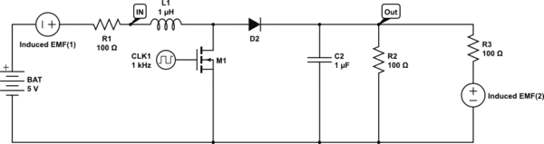

A battery of constant voltage is in series to a conductor that is placed in a changing magnetic field over time, inducing an EMF with a polarity as indicated in the circuit as "Induced EMF(1)", both the battery and the induced EMF(1) are in series as the input voltage to the DC converter, the intention is to increase or decrease the applied voltage and ultimately the current(if there is a load). The outputted voltage( BAT + Induced EMF(1)) is opposed by Induced EMF(2) that is exactly the same in magnitude to the induced EMF(1), both I-EMF(1) AND I-EMF(2) are induced at the same time. I'm confused as to how things would turn out due to the converter, in a general sense what might happen?
Circuit schematic:
Circuit schematic of a boost converter: BAT 5 V and Induced EMF(1) in series with R1 100 Ω and L1 1 μH to node IN, then diode D2 to node Out, with CLK1 1 kHz driving MOSFET M1, C2 1 μF and R2 100 Ω at Out, and R3 100 Ω in series with Induced EMF(2) on the right.

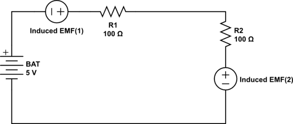

If I excluded the DC converter like so:
Circuit schematic: a 5 V battery in series with Induced EMF(1), a 100 Ω resistor R1, a 100 Ω resistor R2 and Induced EMF(2), all in one closed loop.
It would be easy, the net voltage would be: BAT + Induced EMF(1) - Induced EMF(2) = BAT. Since the Induced EMF(1) = Induced EMF(2). However, what if the convert is in between as the first schematic? And let's say the inputV(to the converter circuit)>outputV or vice versa intputV < outputV? The result is the same?

You don't show any feedback. Is that intentional? Do you intend for this circuit to be run open-loop at some fixed duty cycle for the switch?
Yes I did that intentionally, I'm focusing primarily on the odd situation of the induced EMF's(hence why there isn't even a reasonable load...). More concerned on how the converter would behave considering fluctuating inputs, and the whole EMF issue. I guess this is more educational for my self teaching than an actual circuit that I would use.
Initially while working on the circuit, I concluded that the induced EMF's(1&2) would cancel out since their equal and opposing even if the converter is present in between. But, what confused me and made me think twice was the fact that the applied input voltage( that is BAT+ Induced EMF(1)) goes through the converter and is outputted for example at a lower voltage the output voltage is less than the induced EMF(2) it would cancel it and then what...? The remaining voltages is inputted through the converter in reverse :confused:?
I'll assume that 1KHz is enough time to fully charge and discharge, and all elements are ideal.
Break it down into the energy at the end of the charge period in L (1/2 L*I2) where I is (5V + EMF)/100
That get dumped into C (where Energy = 1/2 CV2 and drained by the 100 ohms and 100 ohms in series with EMF2
Note that EMF1 will increase the current through the inductor and EMF2 reduces the current through the second resistor (I think your polarities are wrong).
Think about the increase in energy in the inductor due to EMF1 relative to the effect of EMF2 on the energy drained from the capacitor.

I think you meant to leave out the extra 100 ohms on the DC/DC circuit (R2). Not sure why it is there.
One thing I overlooked is that the diode will conduct when the transistor is off and the capacitor has discharged to a voltage that allows the diode to conduct. The capacitor will never go to zero when the transistor is off, but will go to zero when the transistor is on.
I really don't have an answer for you. You need to set up a sim.
I'll review that... I copied the circuit from someone so not really either.

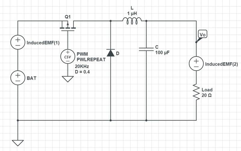

Adjusted the circuit diagrams for Buck converter:
Buck-boost style DC converter schematic: battery BAT, MOSFET Q1 driven by PWM 20KHz D = 0.4, diode D, inductor L 1 µH, capacitor C 100 µF, output Vo across InducedEMF(2) and Load 20 Ω, with InducedEMF(1) in series with the battery.

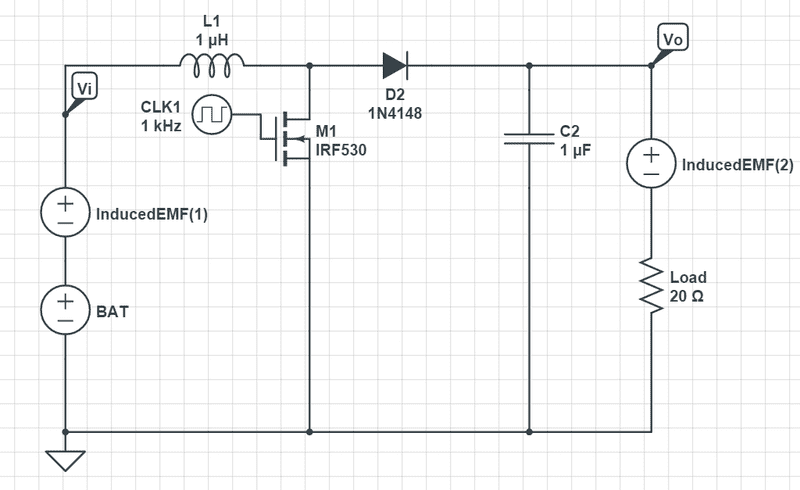

And for Boost converter:
Boost converter circuit schematic: battery and InducedEMF(1) source at input Vi, inductor L1 1 µH, MOSFET M1 IRF530 driven by CLK1 1 kHz, diode D2 1N4148, capacitor C2 1 µF, output Vo with InducedEMF(2) and a 20 Ω load.
In both cases, can I manipulate the circuit so that the Load would have only the BAT's applied voltage?
And somehow cancelling InducedEMF(1) & InducedEMF(2)?

You have the tools to analyze this. First you need to be able to analyze the simple boost and buck without the EMF. Once you understand the math of how they work you can determine how the EMF affects performance.
I don't think you understand the basic circuits even without the EMF. For example, what is the final current through L1 in the boost after the 500uS on period? And what will be the voltage at C2 at the end of the 500uS off period. You would be better served to first understand boost and buck operation in the fundamental sense and then the effects of real components, before tackling your seemingly random unrealistic question. At least that knowledge would be useful, and of course it might help you solve what you are asking.

You are asking whether
(Vbatt + EMF) X (converter ratio K) - EMF = Vbatt
is possible ?
What does 8th grade algebra tell you ?
