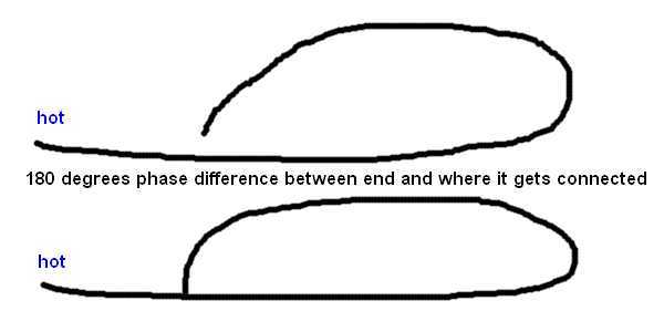

Welllll, not exactly. See, in your scenario there is a single loop going back to the source. Mine is a little different. In my wiring example, the hots connected together would be connected to a resistor and the neutral. But forget about that. Here's a simplified picture. When you have a large length of wire to span, because the voltage has a propagation speed, we get a difference in phase along a single wire, which is what this question is focused on. What's going on in the loop?

I don't understand your pictures. The second one shows a short circuited loop closing on itself.
Yes, it is shorted on itself. And there is a phase difference between where it is shorted, before shorting it. so what happens? that is the question.
OK, now I got your question better. Wave propagation in the context of house wiring, with a 625 km long loop in your house. Will that short the generator? No.
In fact you can eliminate the hot leg of the circuit and consider just the short loop. Open the loop, put a pulse in one end, then close the circuit before the pulse can propagate around the loop. Won't the pulse just circulate and decay?

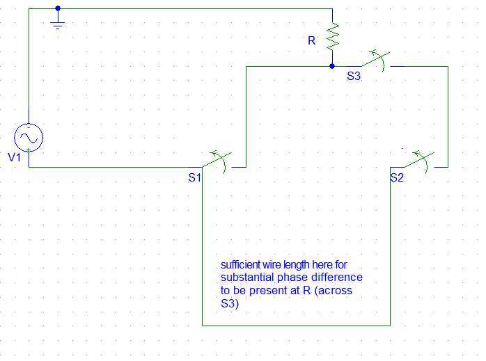

to be clear I've made a better picture. What I'd like to know is what kind of power would be going through such a circuit, and what would be happening when S3 is closed (when S1 and S2 closed). What would happen with a 90 degree phase difference across S3? or 180?

You show one Earth connection. Is that the MEN link or a connection to a ground plane?
Building wiring codes require the active and neutral travel together and pass through the same holes. That reduces radiation. You need to redraw your circuit with wires in bundles that have sum-zero currents. Only then can you consider the phase at different points in the circuit.
Your circuit seems to be something a bit like a 3/2 wavelength hybrid ring coupler.
https://en.wikipedia.org/wiki/Power_dividers_and_directional_couplers#Hybrid_ring_coupler
Tell me more. this is fascinating. I don't know what difference the MEN link or ground plane would make. Nor had I considered radiation. I was simply wondering if the phase difference might act like a short, or whether something more complex would happen. Please, elaborate. What would be the difference in running bundles vs single wire as shown?
Consider two parallel wires, one is the active, the other the neutral return wire. The currents are equal and opposite. Outside the wire the electric fields cancel and the magnetic fields due to the currents cancel.
Between the wires is an electric field determined by the difference in voltage between the wires. Between the wires the magnetic fields due to the equal and opposite currents do not cancel, they sum to double. So between the wires is a strong electric and magnetic field. That is where the energy travels towards the load. When you keep the active and return wires together you prevent loss by radiation of that energy.
