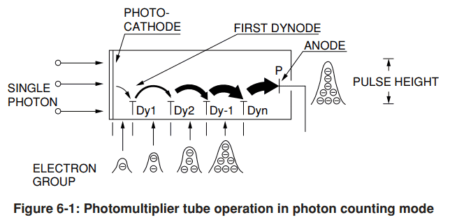

So-called "photon counting" systems do exist, although it does require careful management of your signal to noise ratio. Photon Multiplier Tubes have historically been one method to achieve single photon counting this due to their high gain and high sensitivity.
More reading: Hamamatsu PMT Handbook- Chapter 6: Photon Counting
