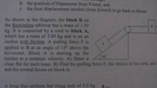

Block B on a frictionless table top (1.5kg) is connected by a cord to block A (3.8kg) with friction on an incline of 40degrees above the horizontal.
Block B is being pulled at and angle 15degrees above the horizontal
Block A is moving up the incline at constant velocity.
Find Pulling force (on B at 15degrees), Tension in the cord, Friction and normal forces on A.
F=ma
F=uN
I found the X and Y components of block A, and i figured that Wx+Friction=F(on blobk B)
But i don't know how to find the rest.
TY in advance!

Umm, as i mentioned, there is a force pulling on block b at 15° above horizontal, and if the system is moving at constant velocity, (a=0) the opposite forces have to be equal. Therefore left (in my case, friction+Wx of block A) = Right (pull at 15° on block B).
If I am right, Tension-Friction-Wx= 0 (ma=0) for block A and Force(15°)-Tension=0(ma=0) for block B

But i don't have the value of friction... How can i solve it?
Usual way …
find the normal force, and multiply by µ :wink:
tiny-tim said:
Usual way …
find the normal force, and multiply by :wink:
But i don't have µ, I only have numbers that i gave in my first post...
ooh, I never noticed that! :biggrin:
You'd better call the friction "µ", and get an answer with µ in it. :smile:
(or email the professor … I assume it's a misprint!)
But it was a question on the test lol... Here, i took a picture of the question in case i missed something.
Thx!
hmm … I still think it's misprint! :redface:
It can't be... It was on the test and many people got it right
