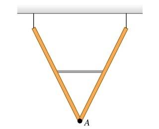

Two identical, uniform beams weighing 260 N each are connected at one end by a frictionless hinge. A light horizontal crossbar attached at the midpoints of the beams maintains an angle of 53.0 ∘ between the beams. The beams are suspended from the ceiling by vertical wires such that they form a "V", as shown in the figureWhat force does the crossbar exert on each beam?What is the magnitude of the force that the hinge at point A exerts on each beam?What is the direction of the force that the hinge at point A exerts on the right-hand beam?What is the direction of the force that the hinge at point A exerts on the left-hand beam?
Ʃτ = 0
ƩF = 0
I have tried to sum the torques and solve for the force of the bar however I end up getting a fraction with a zero numerator. I don't really know how to "see" this problem even after drawing it.
shouldn't do :confused:
show us your full calculations :smile:
Ok,
Let L = length
T = tension of each wire
Fbar = force exerted by bar
Well what I have so far is:
Net torque about hinge = Tsin(153.5)L - Fbar * sin(63.5)L/2 - Tsin(153.5)L + L/2*Fbar*sin(63.5) = 0
And I get a zero each time I try to solve for Fbar
Hi everyone, I actually found out how to do this problem. Given the fact that everything is in equilibrium I can cut the "V" in half and look at each side using torque. Then I can solve for Fbar without getting a zero for an answer. Lol mastering physics...

djMan said:
Given the fact that everything is in equilibrium I can cut the "V" in half …
yes …
as you've probably realized, if you're finding a tension, you have to "cut in half" the thing with the tension before you do your free body diagram, otherwise the tension occurs twice, as a pair of internal forces, which of course add to 0 :wink:
