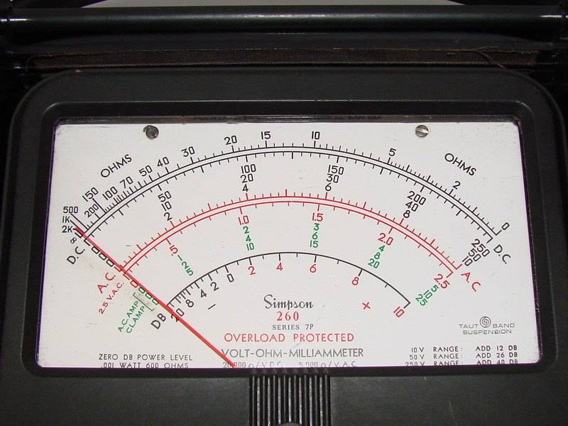

I believe this has been covered on PF already. A search should bring results. dB represents gain or loss. dB with a suffix is an absolute. For instance, 0 dBm is .001 watts into a specified impedance. Often it is 50 ohms. I believe the telephone system my have a similar 600 ohm standard.
indeed, the world famous and much revered Simpson 260 has a db scale referred to 1mw/600 ohms, see lower left
image from http://simpson260.com
