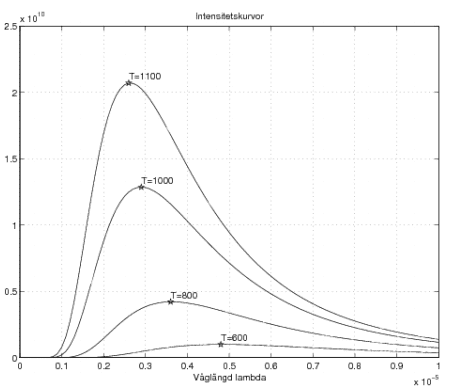

I have a function :
and I want to draw :
where T has values : 600, 800, 1000, 1100 And λ:(0,10*^-5] I have to use max function with two values and the solution must not consist of repeating four times of similar snippets of code, one for each curve.The image should be stylish. For example. so the texts may not cut curves, but neatly placed just above the maximum point.
[/B]
This is the way how I start :
F=@(L,T) 3.7415E-16 ./((L.^5).*(exp(0.014 ./(L.*T))-1));
T=[600, 800, 1000, 1100];
L=0:10^-6:10^-5;
[Lm Tm]=meshgrid(L,T);
fm=F(Lm,Tm);
plot(L,fm)
hold on
grid on
[Y I]=max(fm);
plot(L(I),Y,'*')
And I get :
https://se.mathworks.com/matlabcentral/answers/uploaded_files/70252/image1.bmp
My question is how should I use text function in Matlab to write T for correspond curve
This how I could develop the code but I fail with one thing !
clear all
clc
T=[600 800 1000 1100];
L=0:10^-7:10^-5;
[Tm Lm]=meshgrid(T,L);
fm=F(Lm,Tm);
plot(L,fm)
grid on
[Y I]=max(fm);
hold on
plot(L(I),Y,'*')
%text(L(I),Y,'T= ')
hold on
for i=1:1:4
S=['T= ',num2str(T(i))]
N = L(I)-1.E-7;
G = Y+5.E8;
text(N,G, S)
end
I get this image as result :
https://se.mathworks.com/matlabcentral/answers/uploaded_files/70256/image2.bmp
