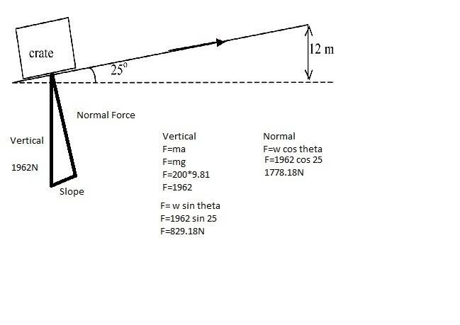

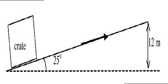

Use the Polygon of forces to demonstrate that the 200kg crate is in equilibrium on the slope
F=ma
I have attached a picture so you understand the problem a bit better.
I have worked out that the weight acting directly down is:
F=mg
F=200*9.81
F= 1962N
The Force acting back down the slope is:
Wx=W(weight) sin theta
Wx=1962 sin 25
Wx= 829.18N
What other forces are acting on the crate?
Thanks, Joe
Hi Joe! :smile:
What polygon did you get that from? :confused:
You're missing the point of the question …
it is asking you to name the three forces on the crate,
then draw a triangle of them,
then use that triangle to calculate the forces (from the given W). :wink:

ive attached a picture of an attempt.
Thanks, Joe
Hi Joe! :smile:
Yes that's the correct triangle, and the correct results.
