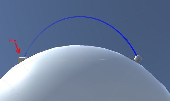

Is it possible to solve for the initial speed of projectile hitting a target given that we know the direction (vector) that it is released at and the point on a the surface that it is hitting? If so how would you go about finding an equation to solve for this?
I realize that this is a relatively easy problem to solve when gravity is always aiming in the same direction, but in the particular case I am trying to solve, gravity is varying as it flies through the air. Basically think of a projectile being hit around a mini planet (see the image below), where the force of gravity on the projectile is,
g = Gconst * mmass planet / rdist2
The trajectory trail in the image below is generated from simulating the projectile's flight and adding or removing initial speed to bring it closer to the target position based on the "final" position. This would obviously be done more efficiently by using an equation that would allow me to solve for the initial speed given the initial direction and final position.
Any help solving this is very much appreciated.

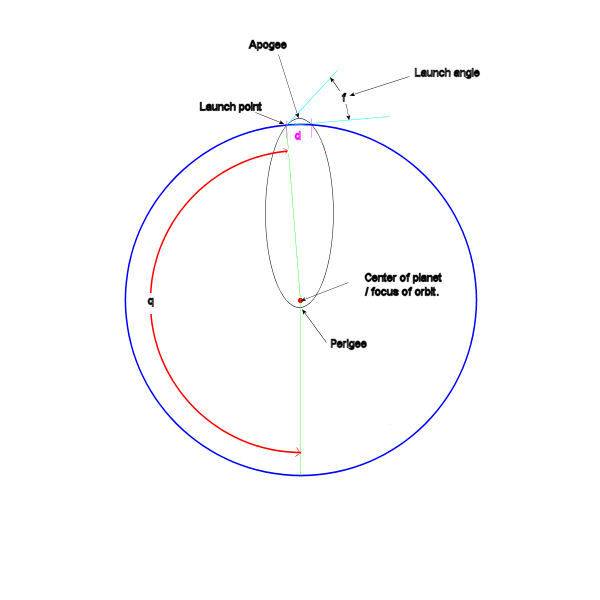

First we consider that the path will be a section of an elliptical orbit, with the apogee at the top of the arc. This puts the perigee 180 degrees or pi radians away (and under the surface of the Earth.) To work this problem out, you have to work out the particulars of this orbit.
First we find the eccentricity. For this, we use the equation:
(1)## \tan f = \frac{e \sin q}{1+ e \cos q}##
where f is the angle from the horizontal our projectile is launched, e is the eccentricity, and q the angle from perigee to the launch point.
If we work in radians we can get q by
(2)## q = \pi- \frac{d}{2R_p}##
where d is the distance between launch and landing points as measured along the surface of the planet and Rp is the radius of the planet.
With q and f we can solve for e with equation 1.
Now we work out the semi-major axis of the orbit using
(3)## R_p= \frac{a (1-e^2)}{1+e \cos q}##
And solving for 'a', the semi-major axis.

The center of the ellipse is not going to be at the center of the planet, but one of it foci will be. The following image illustrate the parameters of the trajectory. Note that the center of the planet and the focus of the orbit are considered the same point. This is one of the things we can treat as true if the mass of our projectile is very small compared to that of the planet. Once the projectile mass becomes significant with respect to the planet, we have to account for the fact that this can no longer be considered the case.

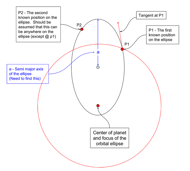

New wrinkle.
If the position on the ellipse of the second point becomes arbitrary (i.e. not necessarily on the surface of the planet). How could you go about solving this?
I have attempted to find q (the angle to the periapsis) with the new scenario but not having much luck there. Any ideas for finding this or the semi major axis directly?

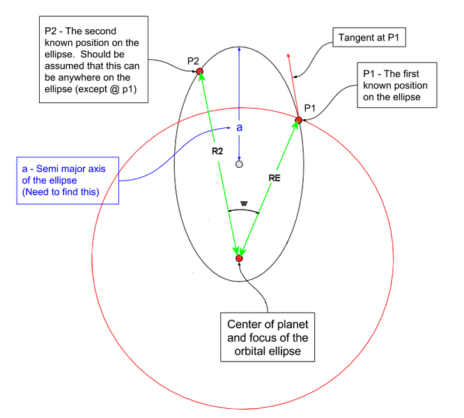

Sorry about taking so long getting back to you on this, but it took some head scratching on my part to get an answer.
Here's what I ended up with:
I started with defining the positions of P1 and P2 as their radial distances from the center of the planet and their angles from perigee as shown here:
RE is the radial distance of P1 and R2 is the radial distance of P2. If q is the angle between perigee and the P1 radial, and w is the angle between the P1 and P2 radials, then q+w is the angle between perigee and the P2 radial.

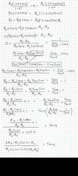

With this information and re-arranging eq 3 from post #6 to solve for a, we can set up the following equality:
[tex]\frac{R_E (1+e \cos q)}{1-e^2}= \frac{R_2 (1+e \cos (q+w))}{1-e^2}[/tex]
we solve for e and equate this solution to eq 1 from the same post.
Then, with the help of some trig identities, we finally end up with a solution for q using just the factors we know.
[tex]\tan q = \frac{2 R_E - R_2 \cos w - R_2}{R_2 \sin w + \cot f (R_2-R_E)}[/tex]
Rather then post the Latex of this solution, I attached an image of it written out. I hope this helps.
