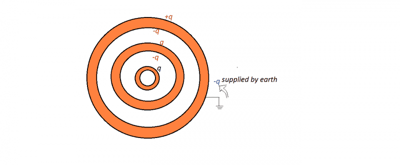

I think the confusion stems from your reading of this para in post #17:gracy said:But that's we did .We did not involve these induced charges in calculation of final potential.
So, if you pick any point inside sphere B at a distance x from the center, at that point, the potential will be kq/2a. Out of that potential, kq/x will be contributed by +q on sphere A and the rest will be contributed by the induced charges on sphere B.
What cnh is saying there is that you can predict by other means what the net potential will be in the annulus, and know that the induced charges will be such as to achieve that. We do not ignore the induced charges, but we do not need to know what they are in order to find the potential.

Now what if question asks find the potential of shell B due to induced charges?will we able to calculate it?
- 42,981
- 10,575
Yes. We know what the potential would be without induced charges, and we know what the net potential is with the induced charges. The difference is due to the induced charges.gracy said:Now what if question asks find the potential of shell B due to induced charges?will we able to calculate it?

I'm not clear as to exactly what you are intending to say here.gracy said:To follow what haruspex said in #34 we should know what the potential of B would be without induced charges.I am confused about how to calculate that.I mean that's what we did while calculating net potential of shell B because we did not involve induced charges in calculation of net potential of shell B.So we will get same result for potential of B without induced charges.And hence potential of shell B due to induced charges will come out to be zero
The potential (due to all charges) at a point on the surface of shell B is ##\displaystyle \ k\,\frac{q}{6a} \ ##.
The potential (due only to the charge on shell A) at a point on the surface of shell B is ##\displaystyle \ k\,\frac{q}{2a} \ ##.
The potential (due to all the induced charges) at a point on the surface of shell B is ##\displaystyle \ -k\,\frac{q}{3a} \ ##.

why did you not involve charge -q which has been provided by Earth to shell C?
- 42,981
- 10,575
That was the third item, "potential due to all induced charges". The induced charges on shell B cancel each other.gracy said:why did you not involve charge -q which has been provided by Earth to shell C?

I did.gracy said:why did you not involve charge -q which has been provided by Earth to shell C?
That charge is at a distance of ##\ 3a\ ## from the origin. It produces no electric field at distances closer to the origin than ##\ 3a\,,\ ## and therefore the potential due to the that induced charge (-q on shell C), is constant at points closer to the origin than shell C.
Any effect from the induced charges closer to the origin than that (those on shell B) cancel each other out.

No ,I thought it is charge supplied by Earth to shell C.SammyS said:A charge of -q on shell C. That's the induced charge, right?
Staff Emeritus
Homework Helper
- 11,986
- 1,584
Yes, it's supplied by "earth", but it is also induced by the other charges.gracy said:No ,I thought it is charge supplied by Earth to shell C.
Alternatively: The −q charge is indeed induced, whether the shell, C, is grounded (Earthed) or not. The grounding simply allows the +q charge, which would be on the outside surface of shell C to "escape".

induced charge -q is on inner surface of shell C.And charge -q which has been supplied by Earth is on outer surface of shell C to balance induced +q charge there ,Am I right?SammyS said:Yes, it's supplied by "earth", but it is also induced by the other charges.
Homework Helper
- 15,536
- 1,917
Well, this means that zero charge is on the outer surface of C, and -q induced charge on the inner surface. So that -q is induced charge.gracy said:induced charge -q is on inner surface of shell C.And charge -q which has been supplied by Earth is on outer surface of shell C to balance induced +q charge there ,Am I right?
In case of zero charge you can say that it is the resultant of one million C positive charge and one million C negative charge, but it has no sense at all.

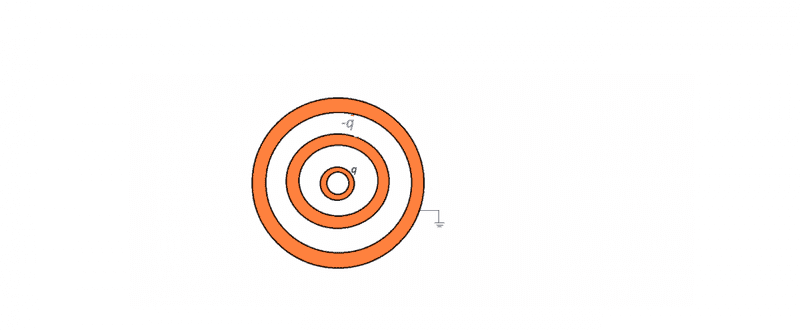

Pardon me for stepping in late but I would make the following observations on this problem. The potential for a spherically symmetric charge distribution will be [itex]V=\frac{kQ}{r}[/itex] for Q the charge within the sphere of radius r, but only for a particular choice of gauge. The more general formula is [itex]V=\frac{kQ}{r}+G[/itex] for G a gauge constant. Usually G=0 so that the potential at r=infinity is zero but you can set it to any value since it is only potential differences that matter. In this problem, you do not want the potential to change within the conductors and you want the potential of the grounded conductor to be zero.
Working in an arbitrary gauge can allow you to solve the problem a bit more easily.
Clearly the E field inside A is 0. The potential inside (and at) A is subject to our choice of gauge.
If q is the charge on A, the potential between A and B is [itex]\frac{kq}{r} + G[/itex] with [itex]\frac{kq}{a} + G = V_A[/itex] and [itex]\frac{kq}{2a}+G = V_B[/itex].
Since B has no net charge the potential between B and C is again [itex]\frac{kq}{r} + G[/itex]. [Otherwise we might have to paste together distinct gauge conditions, different constants so potential is not discontinuous across a shell of charge density.]
This must at C give us [itex]V_C =\frac{ kq}{3a} + G[/itex], (lets say just as we reach the interior surface of C).
Using [itex]V_C=0[/itex] at ground to fix our gauge you get [itex]G = -\frac{kq}{3a}[/itex] and so [itex]V_B= \frac{kq}{2a}-\frac{kq}{3a} = \frac{kq}{6a}[/itex].

##V##=##\frac{Kq}{4a}##?SammyS said:) What is the potential at a distance 4a from the origin due to the charge -q ?
##V##=##\frac{Kq}{3a}##SammyS said:What is the potential at a distance 3a from the origin due to the charge -q ?
Homework Helper
- 15,536
- 1,917
You are right, but Gracy wants to solve the problem with the Superposition principle, that is to get the potential as the sum of a single charged shells, A of radius a and charge q, and the other single single shell C of radius 3a and charge -q.jambaugh said:Pardon me for stepping in late but I would make the following observations on this problem. The potential for a spherically symmetric charge distribution will be [itex]V=\frac{kQ}{r}[/itex] for Q the charge within the sphere of radius r, but only for a particular choice of gauge.
