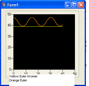

Using the closed form of the solution enhances the problem of energy conservation.
Code:
do {
i++;
t[i+1] = t[i] + dt;
omega[i+1] = omega[i] - (g/l) * Math.Sin(3.1415*theta[i]/180)* dt;
theta[i+1] = theta[i] + omega[i] * dt;
Energy[i+1] = g*l*(1 - Math.Cos(3.1415*theta[i])/180 ) + 0.5 *l*l* omega[i]*omega[i];
omega1[i+1] = omega1[i] - (g/l) * Math.Sin(3.1415*theta1[i]/180) * dt;
theta1[i+1] = theta1[i] + omega1[i+1] * dt;
Energy1[i+1] = g*l*(1 - Math.Cos(3.1415*theta1[i])/180 ) + 0.5 * l*l*omega1[i]*omega1[i];
while (t[i+1] <= 10*per);
thetaplot.PlotXY(t,Energy1);
omegaplot.PlotXY(t,Energy);
theta, omega, energy, use Euler method.
theta1, omega1, energy1 use Euler-Kromer method.
Here is the result a plot of energy vs time.
I believe Numerical Analysis, 6th Ed. Talks about the problems of Eulers method. I can't be for sure because, I don't have my copy handy.
JMD

I can find no reference to Kromer in my books. But looking at what you are doing it is clear that your Kromers method is simply the correct implementation of Euler's method to a SYSTEM of equations. Your first code (what you call simply Euler's) is not the way to solve a system. While the second is. So yes your first program will not work.
Edit:
There is no doubt that there are inherent troubles with Euler, even if implemented correctly. But it is no more unstable or inaccurate for Periodic solutions as any other 2nd order equation.

It's Cromer and not Kromer, my mistake. Every book I've read has Euler as the way that I have it above.
You can show that in Euler-Cromer method (for oscillatory motion over a period) the Energy increase is ~dt^3, while Euler method energy is increase is ~dt.
JMD
