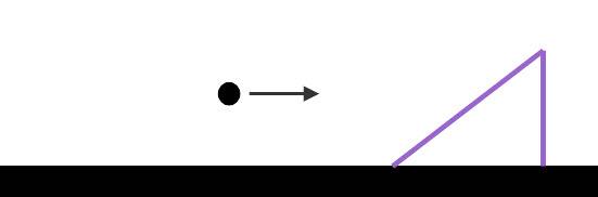

You have rightly understood my question. The first case with ideally smooth walls is not practical because as you say that extra pressure would stay like that so I'm interested in the second case.
Now I could rephrase my original question like this that what's the reason that pressure would become isotropic? I understand that the even the majority of molecules which run into the moving piston at 90° won't reflect back at 90° due to the bumpiness of piston surface. For example, if you throw a ball at 90° toward a smooth wall, it would reflect back along the incident path at 90°. But if the wall has a slope as shown in the attachment, the ball won't bounce back along the incident path. Would you like to elaborate on it a little more like why pressure becomes isotropic? Thank you.

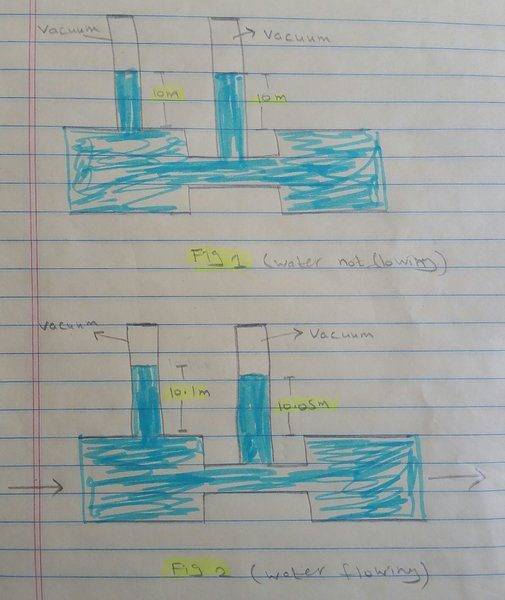

  • Diagram of a black ball with a horizontal arrow pointing right toward a purple right triangle sitting on a black floor, with its sloped side facing the ball.
Well I don't know, but let's consider a piston and a cylinder that look like this as seen from the side: |V|
And then let's ask some questions:
1: what kind of momentum are we giving to the gas when we push the piston down?
2: what kind of speed are we giving to the molecules when we push the piston down?
3: Some question about pressure when we push the piston down

1: Downwards momentum. Sideways momentums cancel out each other.
2: Molecules get extra speed into the direction of the normal of the surface, if the surface is perfectly smooth, if rough then all directions.
3: Molecules get more speed so pressure increases. And volume decreases so pressure increases for that reason too. Now I should say something about why pressure increases in all directions ... well if the molecules don't collide with each other then the molecules are like light. So if we shine a light beam into container with perfectly smooth walls and this shape: |V| what happens? ... Well the beam can't be perfectly collimated, so the initial randomness is amplified as the beam bounces around, and the light becomes diffuse very quickly.
