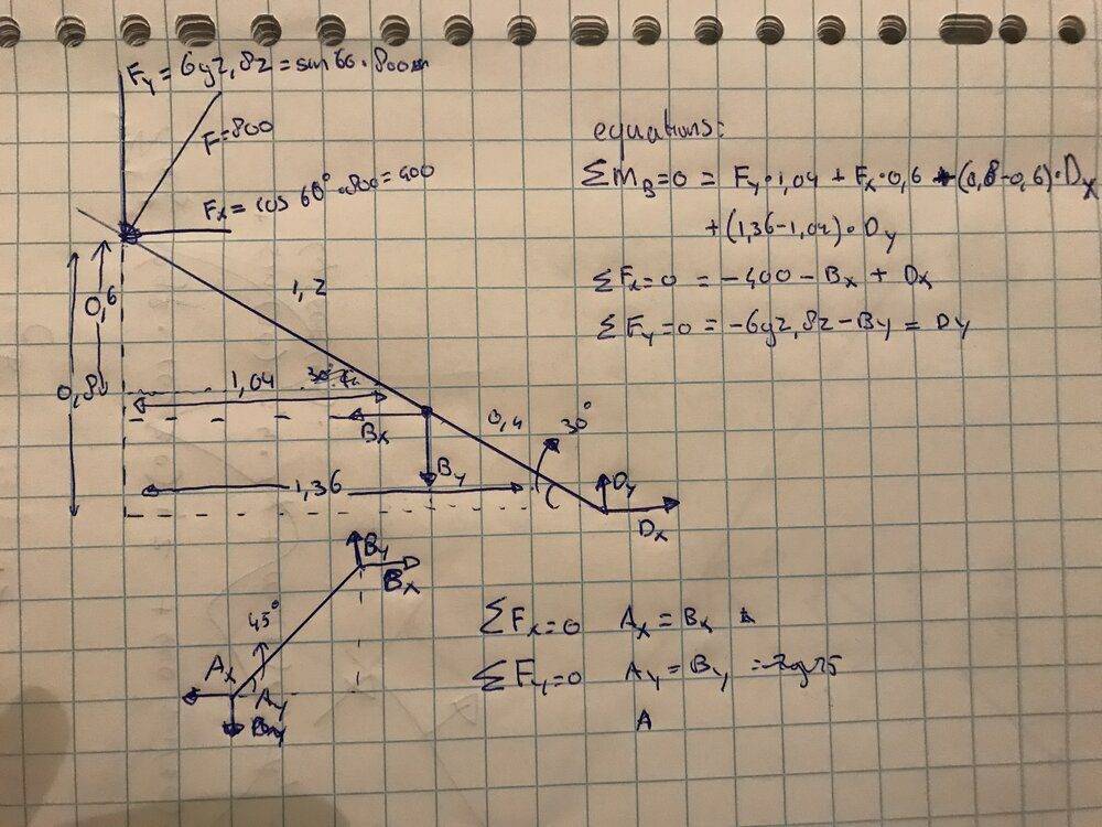

Find the force in point D, both Dx and Dy
Sum of forces = 0, sum of moment= 0
Handwritten free-body diagram of a rigid bar pinned at points B and D, with a 800 N force at 60 degrees, a 0.6 m and 0.8 m offset, and separate sketches of joint forces Ax, Ay, Bx, By, Dx, Dy, with equilibrium equations written beside it.
  • Free-body diagram of a lever system: a rod labelled E with force F = 800 N applied at its left end, a 1.2 m length to pivot B, 0.4 m to point D, angles 75° and 30°, pivot support at A, and a block labelled C at the right.

You have a sign error in the third equation in the top right group. Also, I couldn't read some of it. Looks like ##-6yz,\delta z##.
You need a moments equation for the short spar.

Since there is resistance to compression from the fluid in cavity C, you can consider D to be an anchor to ground in order to determine instantaneous forces and torques for that particular geometry of the mechanism.
Note that the angle of 75° formed between both levers is key in calculating Dx.
