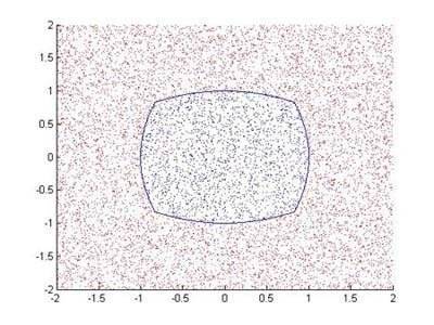

i used MATLAB to run 10,000 simulated dart throwings.
i got p=.2193. which is close to the theoretical value i got.
