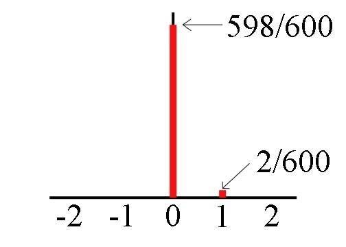

I'll attempt to add some insight into the problem by doing what you already did, but in a different way.
This problem is about summing random variables. Our end goal is find the mean of the sum, and the variance of the sum. If you know the mean and variance of the sum, you can plug those into your Gaussian normal distribution table, and get your final result.
Like you already did, let's start with the mean. But with my method, let's get a little more basic first. Let's ask ourselves, what is the probability that a given phone is taking up a connection line?
A given phone can be represented by a random variable. That variable can take on one of two possible values, '0' and '1'. A '1' means it's taking up 1 connection line, and '0' means it's taking up 0 connection lines. Since it takes up 2 minutes out of every 600 minutes, the probability of a '1' is 2/600 that it's taking up a line. Below is the probability distribution function of a single phone.
Let's call this random variable x
What's the mean of x? Well, it's
μ = (0)(598/600) + (1)(2/600) = 1/300.
Now what we want to do is sum up 2000 of these random variables.
You should know already that when you sum random variables, the mean of the sum is the sum of all the random variables' means.
In other words, when summing 2000 of these random variables together,
Mean of the sum = μ1 + μ2 + μ3 + ... + μ2000.
And since in this case, all the phones' individual probabilities are equal,
Mean of the sum = (2000)(μ) = 2000/300 = 6.667 connection lines.
I don't know how to proceed from here. He wants use to approximate the probability function by a Gaussian distribution. I am not sure what should be the y and x-axis of this probability function. Should the x-axis of Gaussian distribution be the number of occupied lines and y the probability that this number of lines are occupied.Please help me
I've given you the probability distribution function of a single phone taking up a line. I've also given you the mean of a single phone. That was step 1.
The next steps are
(2) Find the variance of a single phone taking up a communication line.
(3) Properly combine the variances of 2000 phones. Now you should have the mean and variance of the necessary communication lines for 2000 phones.
(4) Along with that mean and variance of the sum, use your Gaussian normal table to ensure that the number of phone line connections satisfy 99% probability.

Thanks a lot for your help.
I really appreciate the mathematical precision of your way.
I have done the rest of the problem (see attached file). I hope it is correct.
View attachment E1P2.pdf
'Looks correct to me. :approve:
