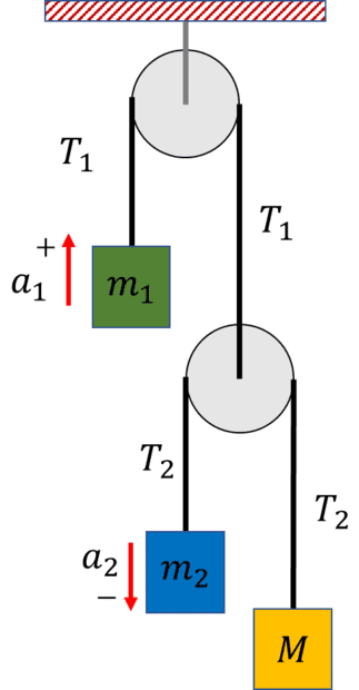

Slow down. You need some more things here. Do a FBD of the lower pulley. What are the forces acting on it? Remember you are isolating the pulley when you do this.

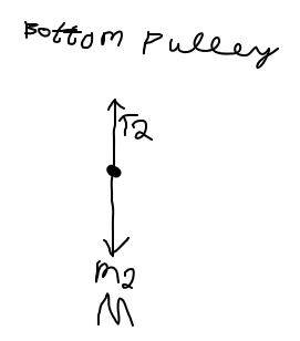

  • #32
The force acting on it will be T2 upward and m2 and M downwards
##m_2## or ##M## aren't forces. You are to be "freeing" the pulley from all other bodies, severing the ropes. What are the forces acting to pull the pulley down. What is the force acting to pull the pulley upward? Are these forces balanced on the pulley?

Erdi said:
If that's the case, forces acting on it downwards is the gravitational force. BUT i don't understand what you mean with the upward force. Because you said to isolate the pulley, but you agreed that it wasnt accelerating (vertically at least) so the upward force is the same as downward force then? which is the gravitatioal force ??
We are freeing the pulley from the other bodies. Not from the forces. What are the internal forces inside the rope that we expose when we "free" the pulley.

Lets back up. What are the forces acting on ##m_2##?
  • #40
That should be just the gravity and tension 1, tension 1= M*g
  • #41
##T_1 \neq Mg## That would be the case if ##M## or ##m_2## were NOT accelerating, but they are.
What is the force balance on ##m_2##

Ok good:
$$T_1 - mg = ma$$
Now for the other mass ##M##?

You might profit if you research "Atwood machine" on the web. Here is a compact treatment but there is plenty more including videos. Please read carefully and try to understand how one proceeds to solve such problems. The method is straightforward:
  1. Choose a system, in this case one of the masses, say ##M##.
  2. Find the net force (sum of all the forces acting on it) ##F_{\text{net,M}}.##
  3. Set this sum equal to the mass of the system times its acceleration. This gives you one equation, ##F_{\text{net,M}}=Ma##
  4. Repeat for the other mass, ##m_2##. Note that if ##M## accelerates up, ##m_2## must accelerate down. You should get a second equation ##F_{\text{net},\text{m}_{2}}=-m_2a.##
  5. Combine the two equations to find the acceleration.
See how this plan is executed in the link I provided. The link does not provide the tension, but you can find it easily with a little algebra from either ##F_{\text{net,M}}=Ma## or ##F_{\text{net},\text{m}_{2}}=-m_2a## if you have an expression for the acceleration ##a##.
