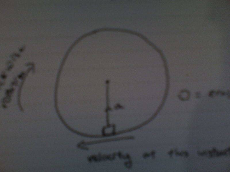

For Qns 3. I meant that at any instant, the velocity of the eraser is tangent to the circle right?( refer to attachment althought it is quite blur)
Since the eraser is in circular motion, there is a centripetal acceleration right?( the "a" in the picture)
and because the eraser doesn't fly off the spinning disk, there is a frictinal force which is equal in direction and magnitude to the centripetal acceleration correct?( or so my notes says) my teacher told that only this frictional force is affecting the eraser.
Now the problem arises that, " any instant, the velocity of the eraser is tangent to the circle ". so naturally shouldn't there be also a frictional force opposing this velocity at that instant?? this in the end makes up 2 frictional force acting on the eraser, instead of the " my teacher told that ONLY this frictional force is affecting the eraser." mention above.
+ hope i explained clearly+
This is all good.
This is not so good. You have said it yourself, velocity. Just because the velocity is in that direction doesn't mean there is a force. Forces create accelerations. Is there any force acting tangentially to the eraser? Is the eraser traveling at a constant speed? Remember Newton's first law. Remember that the eraser is traveling at the same velocity as the disc.
