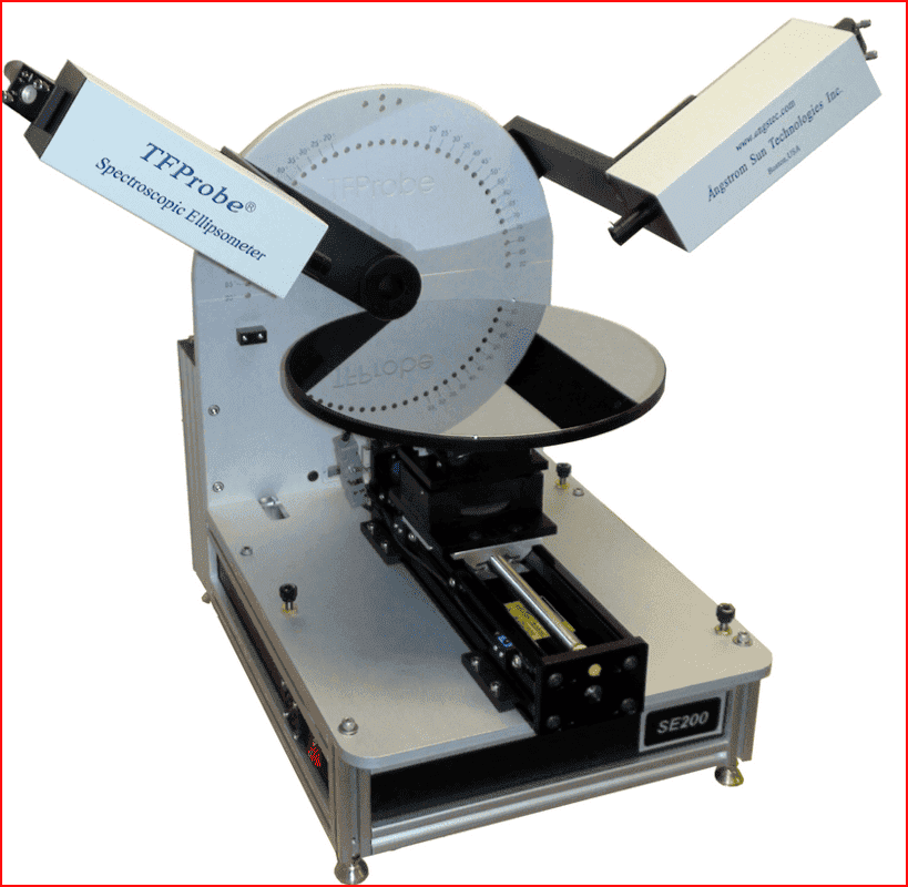

Grambo777
Hi folks!
For those of you who are familiar with ellipsometers, are the following some significant pains/problems with the apparatus? Are there other significant pain points?
1. The machine is too bulky.
2. The change of angle is too slow.
3. The minimum angle is limited by thickness of arms.
4. The arms restrict the access for the imaging system thus limiting resolution.
5. Angular manipulators of heavy arms require precise and expensive mechanical equipment.
Thank you! We are researching various improvements to this apparatus.

http://www.angstec.com/fckimages/image/product/Spectroscopic Ellipsometer SE300BM.jpg

I used an imaging IR ellipsometer a long time ago (Mueller matrix/Stokes vector) and while I have some ideas for improvement, I'm not sure we are talking about the same kind of device.
Certainly, your points are valid- the required precise angular positioning of source and detector is what drives a lot of the size/slowness/complexity. However, I would also expect the device and measurement requirements in UV, visible, or IR lead to significant application-specific design choices.
For example- are you aiming at a spectral measurement, an imaging measurement, or trying to combine both? Do you have a specific performance metric you are trying to optimize? Am I (unwittingly) helping you compete with J.A. Woolam?

Talked with the researchers today, and the elements they use in their design should be valid for the wavelength ranges you mention. The aim is to perform spectroscopic ellipsometry (with a broad-range light source in the illumination arm and a spectrum analyzer at the detection side). We are interested in both variable angle ellipsometry with high-resolution microscopy.
