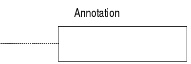

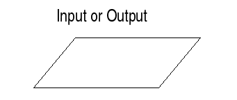

Flowcharting: The following symbols are used in flowcharts. You can find these symbols in MSOFFICE in the top menu bar. Now when you use them, you know the meaning behind them (yes, they actually mean something. There not just random squares and circles!)
In general, there are four flowchart structures:
  1. sequence
  2. decision
  3. repitition
  4. case
