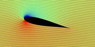

Because I see upward movement of air ahead of wing...not downward..
That's an airfoil, not a wing. It's 2-dimensional. The downwash is a 3-D wing effect that doesn't occur in this 2-D case.
OK just reduce this upwash a little but and you get picture for wing.
Or you want to say that air moves downward ahead of wing ?

By the way this CFD is made on wing , it show airfoil because show streamlines at one place at wing ..it show wing profile at that location

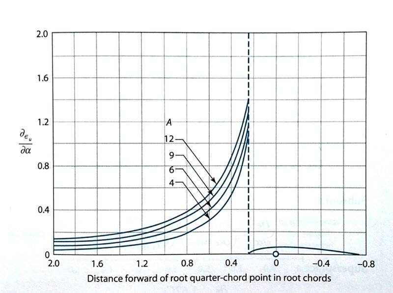

This is upwash ahead of wing for different aspect ratios.
This CFD is made on wing , it show airfoil because show streamlines at one place at wing ..it show wing profile at that location
