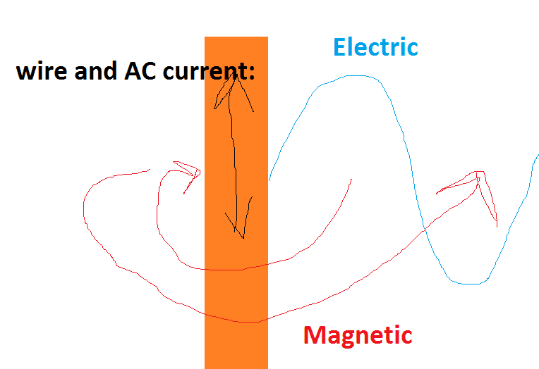

  • #32
tech99 said:
If the AC is a high frequency, then the modes described become important.
Just for completeness, regarding the radiated fields, of course these will travel away for ever as lost energy. The electric radiated component is at right angles to the longitudinal E field near the wire and so it can have a different value. These are the radiated and induction E fields encountered with antennas. However, it seems that the magnetic radiated component is wrapped around the wire and cannot be distinguished from the transmission line field, with which it is identical. So close into the wire, we cannot distinguish radiated and induction components of the magnetic field. The magnetic field from the part of the wire behind the impulse, where the current is steady, initially falls off with 1/D, but when the distance is about greater then the length of the wire, it will fall off very rapidly. The radiated component will continue to fall off slowly as 1/D for ever. This action of waves on wires seems to be very interesting.
Ah, so for a low frequency electricity isn't a TM, interesting.
How is there electric components in the direction of propagation and at right angles to propagation? Radiated EM has always interested me, I ignorantly assumed the HF radiated the magnetic component and as it switched there just had to be an electric component by default as the magnetic field radiated away. Probably childish of me...actually is this something like what you mean:
Is that what you mean by radiated E component perpendicular to the longditudinal E field, because that's what I did envisioned.
When you say the transmission line field, is that which energy snaps back into the wire after you stop exciting the wire? (as in, inductance)
But what did you mean by the "magnetic field from the part of the wire behind the impulse, where the current is steady"?

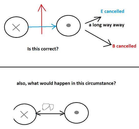

  • #33
tim9000 said:
Ah, so it's the electrons ONLY on the surface, that are responsible for radiation leaking out, that dose make sense.
No. The electrons on the surface stop the vast majority of the external EM fields getting into the conductor.
The electrical energy does not travel in or on the conductors. It travels between the conductors, guided by the surface of the conductors.

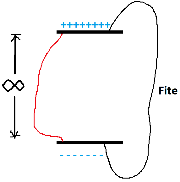

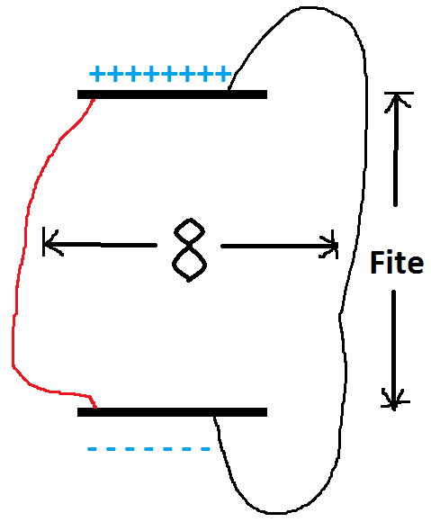

Yeah so the free electrons are like an extremely shiny mirror to EMR, but I'm a bit confused. Are you saying my diagram of EM being emitted is incorrect? Because clearly there is a B-field around a live conductor, however I understand that radiation incident on a conductor would have a very hard time going in far, or at all.
I find that statement about it traveling only between conductors interesting because it's not something that I've ever considered to be the norm for run of the mill conductors. So what if I had an infinitely long conductor, that is, there is an infinite amount of space between the return path conductor, and the positive terminal of the source? Does that mean no energy or current would start to flow? Actually I'll give a different example:
Say I have an infinity long distance the return path between two charged parallel plates (I don't know if this is an appropriate example of an electric source), does the electric field have to radiate off forever before charge can flow?
Sorry, Probably a silly thought experiment but I'm trying to get my head around the fact that there is no E-field in the wire, yet a B-filed surrounding it.

  • #35
No. When a two wire line is connected to a signal source, a differential wave travels away from the source guided by the two conductors. That transient wave will roll on down the transmission line, being attenuated by resistive losses and radiation until what energy remains reaches the load. There can be many transients traveling in a train down the line at one time. There will also be transients traveling back up the line due to impedance mismatches on the line and at the load.
If the conductors are far apart the energy density will be sparse and some “antenna” type radiation will take place. If they are close together, the energy will be dense between the conductors. By keeping the conductors close the energy radiated can be reduced. A coaxial cable internalises the fields and reduces cross coupling of stray signals.
I have no idea what you are getting at with that diagram.
Were you of the opinion that energy could not flow until the signal had run all the way down one wire, then all the way back up the return wire ?

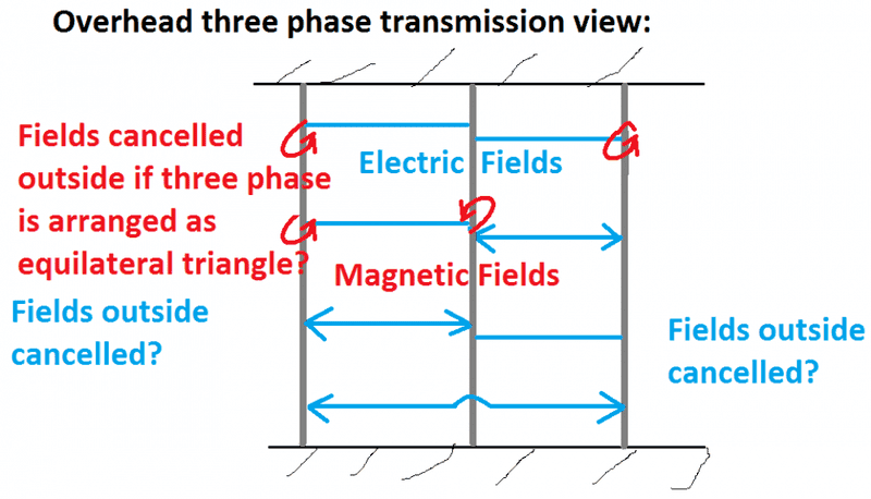

In my last diagram I was trying to illustrate...nevermind. Yeah I was thinking maybe the electric field had to fully circulate before the current can flow because I was thinking about all the electron charge stays spaced evenly (doesn't bunch up).
So what would (by your definition) be the distance between three phase transmission? I assume you'd say the conductors are far apart? (What, like at least a foot between each aerial bundle) And the conductors of your extension cord are close together (because the conductors insulation is butted up against each other).
Energy propagation of three phase electricity:
Say that in the above figure the waveform is something like LHS is peaking, the middle is bottoming out and the RHS is climbing.
So I assume it doesn't matter other than increasing cross coupling or inductance if the conductors are close or far apart (it doesn't matter if the field is dense or sparse) the energy is still the same and the current will flow just as well.
So in principle this is still different from a micro-strip or wave-guide, neither the electric or magnetic component is in the direction of propagation?
How does the electric current propagate forward if there is no source electric field longitudinally?
Thanks

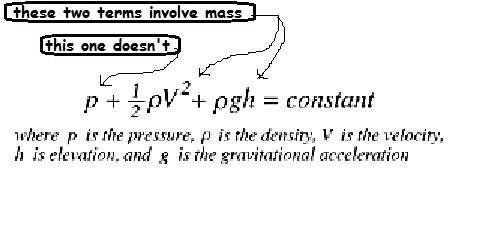

Interesting, so even though a reaction turbine isn't pretty to look at, it's more efficient than an impulse turbine?
I don't think i said more efficient
just the reaction stage let's steam expand.
tim9000 said:
Hmm, I never thought of potential as being how hard they're pushing on each other, I always just thought of them like suspended in a gravitational field from an height. So on this train of thought, we could say that C*V is like holding C electrons at a height of V.
Ahh the water analogy - it falls to ground as it exits the garden hose .
Bernoulli
I switched my water analogy long ago to use the pressure term because
within the constraints of a circuit
electrons have so little mass they're insensitive to gravity
and so little velocity the middle term disappears (exception when they're in a beam as in a CRT)
I encourage people to use pressure not height because to allow gravity invites misconceptions of Ground. It's not gravity that pulls lightning down.
see above objection.
A Coulomb X a Volt is to me more like holding a mole of charges at one atmosphere.

  • #38
That is not possible with balanced 3PH as there is a 120° angle between phases. One phase cannot be high at the same time that another is low. The sum of all three line voltages will be zero. The sum of all three line currents will be zero.
The biggest voltage changes along the line are due to the transient wave traveling along the line. Losses along the line due to resistance also result in longitudinal voltage drops, but only in proportion to the energy lost in the line resistance. That is because each section of the line represents a small load in series with the intended output load.

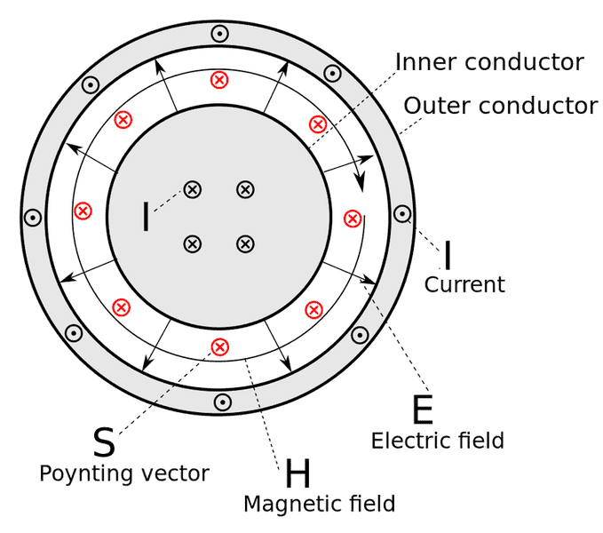

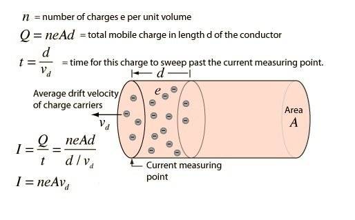

  • #40
dlgoff said:
Image compliments of
Thanks Don
as I've said so often i don't trust formulas until all the terms are defined :smile:

  • #42
Electrons are not like billiard balls. The kinetic energy of electrons is negligible, even when electric power transmitted is huge.[/QUOTE]
When an electron moves, it builds a magnetic field, so that energy has to be supplied to get it moving. It is as if it has additional, or virtual, mass, and the inertia which results from this must appear as inductance.
  • #43
tim9000 said:
how is there a longitudinal voltage at all, if all the energy is between lines at right angles to the line itself?
The energy travels along the line, not at right angles to the line. It is the electric field that is at right angles. The wave is traveling along the line. For any sinusoidal component, half a wavelength away the polarity is reversed. That gives a voltage gradient along the line but it cannot be measured because the propagation velocity will also occur in the meter leads.
There are two waves on the wire. One is the forward traveling wave, the other is a backward traveling wave reflected by the impedance mismatch at the load or along the line. Those traveling waves do not interact in the line, but where we make measurements we measure the sum of both which appears as what we describe and imagine to be a standing wave pattern.
The line is a good conductor so it takes very little voltage drop to drive the current against the copper resistance. Each small fragment of resistance along the line costs some energy, reduces the traveling wave voltage and generates another small backward traveling reflected wave component necessary to keep the directional ratios of v/i = Z0, the characteristic impedance of the line.

Yeah, I really don't understand how 'there isn't'?
Is the B field Outside the coax (below) anti-clockwise? And is the B field Inside partially canceled by the current in the other direction?
https://www.google.com.au/url?sa=i&...f1iqT5Bq4uHISC9aOSveT-ig&ust=1471353705804123

Is this diagram (frame at the top) subject to your description:
Anyone, Please answer the questions in the frames at your leisure.
Thanks very much!
There are no fields outside the coax due to signals inside the coax. The current flow on the outside of the inner conductor is equal and opposite to the current on the inside of the outer conductor. Any currents on the outside of the coax will be related to currents in the external environment, they form a separate transmission line with a different velocity factor to the inside surfaces of the coax.
You must stop confusing the two quite independent directions of energy propagation on the line from/with the two equal and opposite surface currents on the conducting surfaces of the one line. Your question is ambiguous unless you make it clear what you are referring to and in which direction you are considering it.
Sorry about the ambiguity, I'll try again. So if I was looking just at the outer conductor in the picture, with the current going out of the page, there would be a magnetic field anti-clockwise; however you said that the current is only flowing on the Inside of the outer conductor, so there is no magnetic field outside the outer conductor. So I am wondering why there is still a magnetic field inbetween the two conductors? Because the right hand rule for the inner conductor of the picture is shown, so I'm wondering why there is no magnetic field due to the outside conductor.
As for the confusion of direction of energy propagation, I wasn't aware I was doing that, but I concede that I may have been. Are you implying that if the magnetic field WAS canceled inside that there wouldn't be any energy propagation?
What about the top frame of the second picture, with E in blue and B in red, was that what you'd previously meant when we were talking about a two wire conductor (circuit)? [What you meant by the E field being in between, and at right angles?]

You can't just look at the outer because there has to be a return path for current to flow. The 'corkscrew rule' tells you that the magnetic fields add in the inside and cancel on the outside. Look at the diagrams further back in this thread. E fields are zero outside too. A
The inside of the outer conductor is a excellent conductor. That makes it a good EM mirror. Any magnetic field incident with the inside surface will induce a perpendicular longitudinal current that will create a reverse magnetic field to cancel the incident field. Those two fields cancel everywhere outside the inner surface of the outer conductor.
You are hypothesising that the magnetic field inside the transmission line is caused by a current flowing “in” the conductor. But that current was induced in that mirror surface by an incident internal magnetic field. You are forgetting that the EM field within a coaxial cable is constrained to the dielectric by the surface currents on the reflective “walls”.
When you connect a transmission line to a signal you are connecting the dielectrics and the conductive reflective walls. You do that by making sure that longitudinal surface currents and electric field between the surfaces will not be interrupted at the interface.
Hypothesising your own personal theory is a most inefficient way of approaching the subject. It wastes your time and the time of those who answer your questions. You question the paradigm by proposing a simpler model of reality that does not fit the paradigm. You then call for someone to say why your poorly specified model is wrong. That requires they understand your immature model, which is different to their reality. It is better to read and understand the physics than to learn in an ever changing feedback loop where communications in the English language gets two chances to be misunderstood per cycle.

I'm not sure what you're implying here. Are you suggesting that the internal B field is eliminated due to reflections? (perhaps not) There is a B field inside the 'cavity, which is circumferential (Transverse). There are a load of links that show how this can be calculated using Ampere's Law and it is finite at the inner surface of the outer conductor and at the outer surface of the inner conductor. This link shows it in detail but there is a graph showing the results of the calculations and the way the field varies with the radius. It shows that the external field is zero and that it exists throughout the conductors (depending on the resistivity)
If tim looks at the link, above, he will see the actual situation and will not need to try an alternative personal approach.
Yeah I think I will need to look at that link to figure out what is going on with the B fields and how they are cancelling. Thanks
The bottom picture in my post #46 (particularly the top frame) I was trying to illustrate my interpretation of something(s) you said earlier:

tim9000 said:
(also according to @sophiecentaur I'm applying it wrong, which doesn't help)
I have to backpedal here a bit. With a two wire feeder the B field between the two conductors will have contributions from both conductors but, of course, with a continuous outer, there is no contribution to the B field inside the cavity - if you consider the continuous outer as a number of parallel conductors with equal currents flowing in them, the 'corkscrew rule' will cancel the fields from diametrically opposite conductors. But Ampere's Law gives you the answer in a more pukka way.
tim9000 said:
what if they (the conductor and return conductor) were infinitely far spaced away from each other,
That's not an acceptable model to work with as you cannot connect a source or load in a conventional way. Your suggestion makes me think of radio communication between two antennae.

I was more interested in if the diagrammatic arrow representations of how you could think of the energy transfer component of the E and B actually looked, in the picture were accurate.
(also, what would this 'divergence' due to leaking power 'look like'?)

Why not? The E field is normal to the wire, the B field is in circles round the wire and the power flows along the wire. The fields are (at least nominally) transverse to the direction of power flow. (We ignore the forward component of the E field, which seems to get so many people steamed up because they think that field component is relevant)
Without bothering to actually draw it, I can describe it as having the Poynting Vector S parallel with the wires in the centre and very slightly spreading 'outwards' at locations near the wires. The divergence will be small as the radiation resistance is very low. If the wires were significantly resistive, part of the power would be 'into the wires' (more divergence, I guess) so the total flux (between the wires) would get gradually less and less. The explanation for this divergence is that the speed of propagation near the resistive wire (or the radiation leaves from sections of it) is a bit slower. The same effect can be seen when a Vertically Polarised Medium Frequency signal travels along the ground (a ground wave) and it is constantly 'dragged' and dissipated by the ground, giving a slight forward slope to the E field, directing Power down into the ground. It keeps the level of received signal higher than you'd expect because energy above the ground gets directed downwards. The 'shadow' of an MF signal, produced by the presence of metal buildings in a city, gets repaired by this mechanism and the received signal beyond the city gradually recovers.
