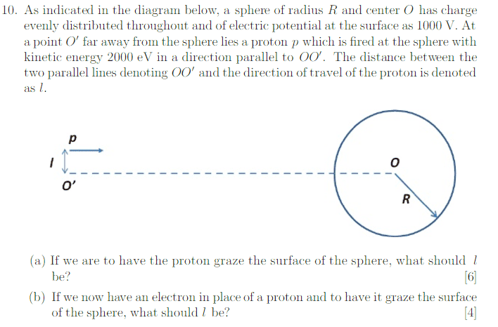

Diagram of a charged sphere with centre O and radius R, and a proton p fired from far away at kinetic energy 2000 eV along a dashed line OO' with perpendicular offset l.
potential energy = -kQq/r
potenial = kQ/r
i am not quite sure how does l play a part in this experiment since it is far away l is insignificant and the only initial energy is kinetic energy and final is kinetic and electric potential energy i can calculate the final electric potential energy and initial kinetic energy is given so hence at most i can only calculate final kinetic energy but how is that going to help me find l[/B]

It is a central force field, there is one more conserved quantity, what is it?

is it the work done on the proton?
Why should it be constant during the motion of the proton?

In a central force field, like that, the angular momentum also conserves.
oh wow that is really smart is it because the force is constantly radially out ward hence no net torque on proton about the centre of sphere
so ,
initial energy = final energy
2000eV = 1000ev + 1/2 m vf2
vf = √(2000ev/m)
then by what you said conservation of angular momentum i am assuming you meant about the centre of sphere
hence
m ri x vi = m rf x vf
ri x vi = rf x vf
letting distance o to o' be s
√(l2 + s2) √(4000ev/m) sinθ = R √(2000ev/m)
√(l2 + s2) l/(√(l2 + s2)) = R /√2
l = R/√2
am i right for part a by the way thanks for the amazing insight really inspiring question

It is right, good work!
omg thanks so much that one hint of yours helped me so much i was initially initially thinking of calculus
