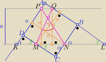

Hint
1 / α + β = 90
2 / it is enough to note that the triangles
KNP and MLQ (they have two heights of length "a") so they are isosceles
so |∡NMQ| =90 - α/2 and |∡MNP| =90 - β/2
γ=(α + β)/2=45
