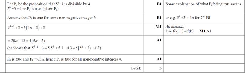

See attached
Mathematical induction
Ok, would i be correct to approach it this way,
Let ##n=1##. If ##n=1##, then ##5^1+3## is divisible by ##4##, the statement is true for ##n=1##.
Assume its true for ##n=k## ∀ ##kε\mathbb{z}^{+}.## Then ##5^k+3## is divisible by ##4.##
i.e ##5^k+3=4m## ∀ ##m ε\mathbb{z}^{+}##
Let ##n=k+1.## Then,
##5^{k+1} +3=5^{k+1} -5^k +5^k +3##
##=5^k(5-1)+5^k+3##
##=5^k(4)+5^k+3##
##=5^k(4)+m##

Looks good, except that the induction base should be ##n=0##.
And of course, it is easier to prove it by the fact that ##\mathbb{Z}\longrightarrow \mathbb{Z}/4\mathbb{Z}## given by ##n\longmapsto n \pmod 4## is a ring homomorphism, i.e. modulo respects addition and multiplication.
