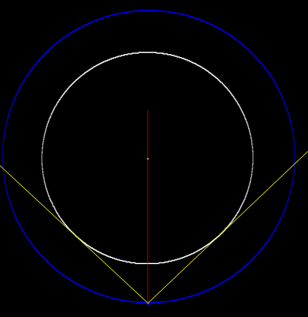

Here's Earth's orbit and Venus in relation. The yellow lines represent maximum angular separation from the Sun (viewed along red line.)
Diagram of a circular orbit inside a larger blue circle, with a white circle centered inside, a red vertical line from the centre downward, and two yellow tangent lines from a point on the outer circle touching the inner circle.
During the whole of the orbit as seen from the Earth, the maximum separation is ~47 degrees.
Thank you. I think this might do it for me.
Zz.

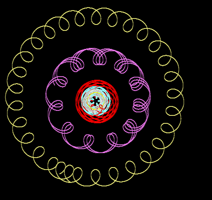

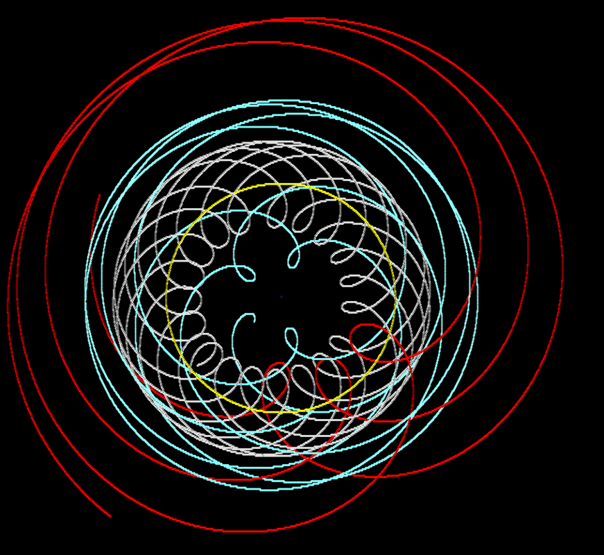

From the theory of relativity, there is no absolute center of the solar system. Putting the sun at the center (center of mass) makes all analyses much simpler. However one could just as well put the Earth at the center - getting very weird looking orbits.
Like this for the the inner solar system:
Red: Mars
Cyan: Venus
White: Mercury
Yellow: Sun
Simulation plot of planetary paths around a central yellow circle for the Sun, with red, cyan and white looping orbit traces for Mars, Venus and Mercury on a black background.
And this, if you expand out to include Jupiter and Saturn:
Concentric looped curves on black: an outer yellow epicycle path, a middle magenta path, and an inner red, cyan and white cluster around a small black cross-shaped centre.
