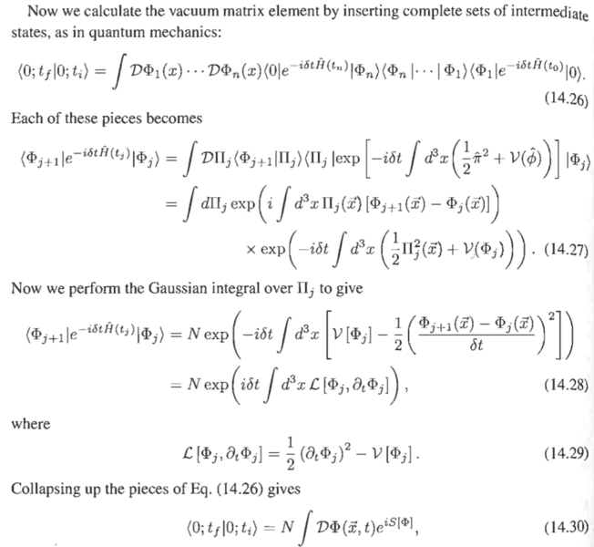

Hello! I am reading from Schwarz book on QFT the Path Integral chapter and I am confused about something. I attached a SS of that part. So we have $$<\Phi_{j+1}|e^{-i\delta H(t_j)}|\Phi_{j}>=N exp(i\delta t \int d^3x L[\Phi_j,\partial_t \Phi_j])$$ What happens when we have the left and right most terms i.e. $$<\Phi_{1}|e^{-i\delta H(t_0)}|0>$$ and $$<0|e^{-i\delta H(t_n)}|\Phi_{n}>$$ Another thing that I am confused about, where are we using the fact that the state in the beginning and the end is ##|0>##? I see we are using the boundaries on time, but I can't see where we use explicitly the fact that we start and end with vacuum i.e. if we had any ##<f|i>## where would we have a different term?

But I am not sure how does he get the first and last terms. He gives a formula for ##\Phi_i##, but ##|0>## is not an eigenstate of ##\hat{\Phi}(x,t)##. What confuses me the most is why don't we have boundary terms for the integral. In QM you have boundaries the for the beginning and end points. So here I would expect the field to begin in vacuum at ##t_i##, go through all possible field configurations and end up in vacuum at ##t_f## be the way he writes it (and from what I understand from the continuation of the chapter) this integral doesn't have a boundary.

Regarding where ##|0\rangle## being the state is used, he doesn't specify this and most books don't. Essentially ##|0\rangle## is an element of ##\mathcal{L}^{2}\left(H_{-1/2}\left(\mathbb{R}^{3}\right)\right)##, that is it is a function over the space of classical field configurations at a fixed time. So at the end and start of the path integral you should have something like:
$$\int_{\Phi_N}\Psi\left(\Phi_N\right)|\Phi_N\rangle$$
with ##\Psi\left(\Phi_N\right)## being the vacuum state wavefunction, the analogue of ##\Psi\left(q_N\right)## for the ground state wavefunction in non-relativistic QM. However you can show there is a measure over the space of fields where ##\Psi\left(\Phi_N\right) = 1##, so this really just becomes an integral over all final fields.
Same for the initial fields ##\Psi_1##.
