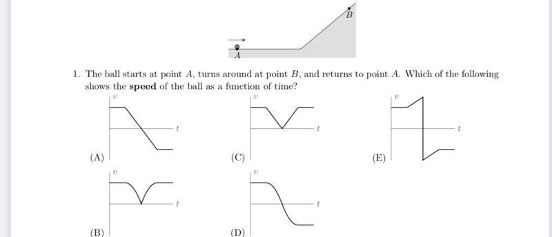

At time t = 0, a small ball is released on the track shown, with an initial rightward velocity. Assume the ball always rolls along the track without slipping.
N/A
(This is the diagram from the problem.)
My professor assigned this as extra practice and I don’t understand why the answer is (C) instead of (B). Why would sharp bends be the correct answer? Isn’t the curved diagram more accurate for movement on a slope?
I'd say it's impossible to choose between B and C as it depends on how you model the transition to the slope.
The track has a sharp, instant bend in it, so the balls acceleration also has a sharp, instant change. Just before the ball hits the bend it has an acceleration of zero. Right after the bend it has an acceleration of ##9.8*sin(\theta)## where ##\theta## is the angle of the slope.

Write the equation for constant acceleration: v=at. v is a linear function of time.
You may be intuitively thinking it should be curved like B because the height will be quadratic with time.
But in my view none of the diagrams is quite right. If the bend is that sharp then there is a sudden impulse, dropping the speed instantly to ##v\cos(\theta)##. To make it look like C the transition to the ramp must have a radius of curvature greater than that of the ball.
... or even if the transition to the slope should be considered elastic ...
Merely being elastic doesn't help since that would mean the ball becomes airborne.

I'd rather say speed conserving. Merely being elastic doesn't help since that would mean the ball becomes airborne.
This was kind of the point. If it is speed conserving in a sharp bend, then the ball bounces off the ramp.
This was likely not considered by the person constructing the problem.

No matter how you model the transition, if the ball moves along the inclined plane the velocity decreases linearly. So (B) is not good. It shows curved lines not only at the transition but for the whole motion on the incline.
