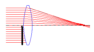

Hey guys,
Can someone give a basic explanation of why a camera can take a picture even if half of its lens is covered up?
Thanks guys...

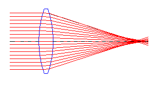

In the image below, the red lines represent light rays from an object directly in front of the lens and located far away so that the light is very nearly parallel when it enters the lens. If you block off the outer rays, perhaps by closing the iris diaphragm, you still have rays entering the camera so you still have an image. Perhaps the key thing to understand is that all of these rays originated from a single point on the object. So if you took a picture of your friend, where the center of the image is at his chest, then these rays all came from a single point on his chest located directly in front of the center of the lens. The rays that came from his nose would be tilted at an angle when entering the lens (imagine tilting all the red rays so that they are traveling downwards slightly). The lens would then focus all of those rays onto a spot at the focal plane further down from the center.
Does that make sense?

Aside: "Covering" the lens is effectively what the iris in the eye or aperture in a camera does. It's primary effect is to alter the brightness of the image.

That's a possibility. Still, the basic explanation doesn't change. Rays of light are still getting through even with half the lens covered so there's still an image formed.
