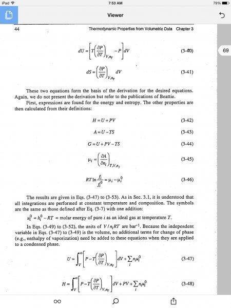

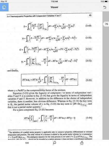

I don't understand how some terms are derived.
How did the last term of 3-47 originate?
How did 3-49 get so many terms from just one term in 3-41?
Why integrate from V to infinite? That is not intuitive.
Thas a functions are unusual because the absolute values of U,H,S cannot be computed. However, the analytical functions are needed to derive the expression for chemical potential?

All the terms you are referring to are the properties of the mixture in the ideal gas state at the given temperature and composition.
Infinite specific volume refers to the ideal gas limit. You need to do the integration to get the correction for the property at finite specific volume.
The terms involving the chemical potentials are for the pure substances at temperature T relative to a specified reference state.
