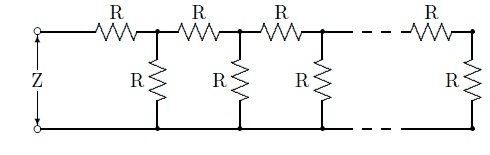

You might ask how your network differs from the classical infinite ladder circuit that is frequently seen in homework problems.
