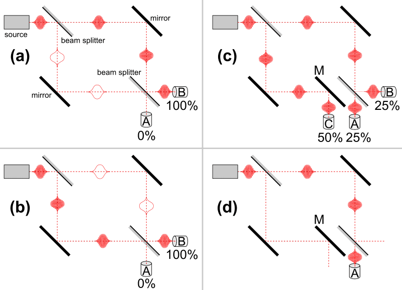

Hey I got a quick question that I figure you guys could answer quite easily and would be easiest to understand if I just show a picture of the diagram:
OK if we refer to figure (c) in the diagram above, how would the outcome(s) change if we replaced the mirror M with another beam splitter? (3 total beam splitters now)
thanks and sorry in advance if this is a really dumb question for some of you.
Non-polarizing beam splitters I guess?
You would get 25% below the additional beam splitter, and a partial interference at the other one. ~72.9% at B and ~2.1% at A if I did not make a mistake.
Where is the difference between (a) and (b)?
here this is taken from the wikipedia page on Mach-Zehnder Interferometers:
Following the analysis given above, we see that in Fig. 4a and b, 100% of the output impinges upon detector B. This is true even if the light intensity is reduced so that only one photon at a time travels through the apparatus. The explanation for this is the same as for the double-slit experiment: it appears as if the wave function of each individual photon travels both paths and engages in interference at the last beam splitter, so that only the wave to B is constructive. In Fig. 4a, although the photon is illustrated as having taken the "northern" branch of the interferometer, it interferes with itself so that only detector B detects the photon. The same holds for Fig. 4b, although the photon is considered to have taken the "southern" branch of the interferometer.
Fig. 4c illustrates the situation where an obstacle has been introduced on the "southern" branch of the interferometer. 50% of the photons are deflected by mirror M, and the remaining photons are split 25% to detector A, and 25% to detector B.
Fig. 4d illustrates the fundamental paradox raised by this demonstration. An individual photon arriving at detector A must have traversed the "northern" path and could not have interacted with mirror M. The arrival of a photon at detector A constitutes proof that an obstacle exists on the "southern" path, but there is no exchange of energy between the photon and obstacle M. How could the photon possibly have acquired information about M without an exchange of energy? This is an example of counterfactual measurement in quantum physics.
and to be clear your saying the results would be ~2.1% for A, ~72.9% for B, and 25% at C?

For your modified setup, which is not shown at Wikipedia, yes.
thanks anyway you could quickly show me how you got the ~2.1% for A and ~72.9% for B...i can sort of intuitively understand why it would now be possible for ~2.1% of photons to reach detector A but I'd love to see the exact math for the partial interference if you get a chance.
also I'm having a hard time understanding figure (d)...why does a photon arriving at A necessarily need information about the mirror M to be possible? if the photon travels the northern path in figure (d) then it makes perfect sense it would have a 50/50 chance of making it through to A now(since its no longer possible to interfere with itself). I don't understand this:
how are those statements true? the photon doesn't necessarily need information about M to have the possibility of arriving at detector A if there is no longer a chance of interference.
the only thing paradoxical about these diagrams to me, are (a) and (b) since its obviously strange that individually fired photons can somehow create interference with themselves...however this is a well established principle of QM.
From the setup without M/beam splitter, we know that we get 100% constructive interference for the amplitudes at B and 100% destructive interference at A. The beam splitter reduces the intensity in that path by 50%, that reduces the amplitude by a factor of 1/sqrt(2).
Before, we had amplitudes of 1+1 at B and 1-1 at 0, now we have 1+1/sqrt(2) at B and 1-1/sqrt(2) at A. The square of those numbers is the intensity, and by comparing this to the setup without beam splitter I get the values for the intensities.
