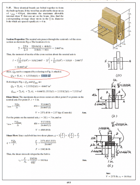

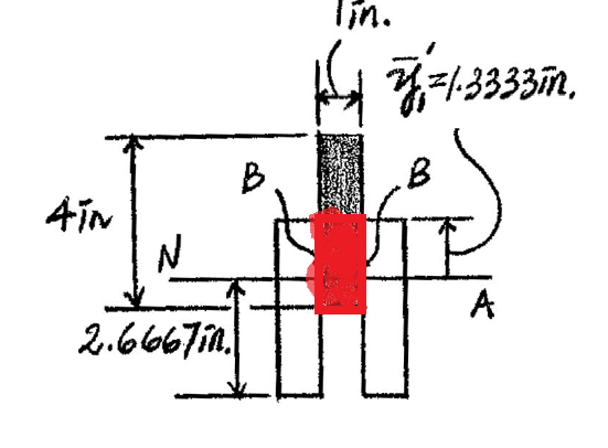

For QB , why shouldn't the QB = red part only ?
Is there anything wrong with the solution given ?
Since When we 'cut ' the boards , the b is the red part which in contact with the other board , right ? [/B]

Nothing wrong with solution. Remember when determining bolt shear, use the full area of connected part when determining Q.

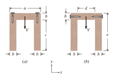

But I was thinking that only works here because the boards are the same dimensions.
In a question like this below (b), if I use one of the side boards I get a different (wrong) answer than if I use the center board.
Part b is a bit more tricky than part a because in part b, the longitudinal shear flow across the nail is into the plane of the page (z direction) on the yz side face of a cubic element, in contrast to part a where the longitudinal shear flow across the nail is into the plane of the page (z direction) on the xz top face of a cubic element. Consequently, in part b, the shear flow is horizontally distributed across the top board, so you need to find Q based on the area of the board in between the nailed joints, and the vertical distance from its centroid to the neutral axis. Then divide result by 2 when determining shear flow, because there are 2 shear planes.
Alternatively, you could use the Q of the area outside of the top cuts, but when so doing, you must use the full area , that is, the area of both vertical pieces times the vertical distance of its centroid to the neutral axis. This a more tedious way of finding it.
Part b is a stronger connection than part a, because the Q in part b is less.
